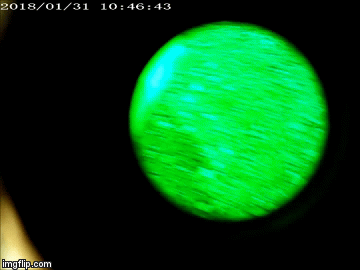

Is there a way to stop a DPSS 532nm laser (0.9watt) from flickering
as in the attached short clip? It is about a 5Hz flicker of significant
intensity-magnitude. Full-disclosure -- it is running off of an
5volt-adapter connected to a power-inverter which is connected to a
12volt car battery. The distance to the laser is 0.34miles.
Below is a gif-video of the flickering. I can tolerate some small flickering,
but my application needs the beam to be primarily steady, not flickering like this.

The car engine was running. But, there is quite a long extension cord from the inverter to the laser. The laser itself should be pretty steady. You can see its reflection-center-point is not moving, in the 2nd clip. I can drop the voltage myself, but at the moment it was a quick way
to be able to turn the laser on/off from 0.34miles away with a remote-push-button on the inverter.
Could there be hot-air rising -- I suppose. But the 5Hz flickering continues on and on and on for three consecutive minutes irregardless of the wind-gusts, etc. I think it is the laser or power-electronics creating the 5Hz 'pulsing' -- I just don't know how/why at this point.
ps: I will look into whether there is close-up pulsing and get back on that point.

What I see in this "videos" especially the second one ist not "flicker" of the Laser, but the result of the large air space between the source and the target. Let me guess - there is no problem with the beam, close to the Laser itself and it gets worse with the distance.
It's essentially the same problem Astronomers face when imaging stars at high magnificaton. Astronomers refer to this problem as "seeing". A thin Laser beam cut through a big amout of air is essentially like tuning a microscope on a star image.
Unfortunately the air is not a perfectly clean and perfectly stable medium. Every even so slight breeze moves air of different temperature through your beam. As you know from watching someone across a camp fire - air of diefferent temperature creates Schlieren and blurries the image. The problem is getting worse at long distances close to the ground. It is easier vertically as air gets thinner in higher regions and you cut through several layers of air instead of keeping within the "ground sheet".
There is no easy way out. You sust can statistically sample the light to find the true center. Astronomers with BIG budget can help themselves with adaptive optics that does cancel out the dynamic variations based on the theoretically expected image.
It does help quite a lot, if you enlarge the beam diameter. The "air bubbles" might be quite small. Once the beam reaches or supersedes the bubble size, it keeps its profile, but tends to wobble around like in this image of the moon.
A thin needle jumps everywhere, as it is refracted by dozens of moving "air lenses". Like on this video (the moving around is due to tracking problems)

At this juncture, I think that you and Immo1282
are correct that it is a mirage-type-effect.
