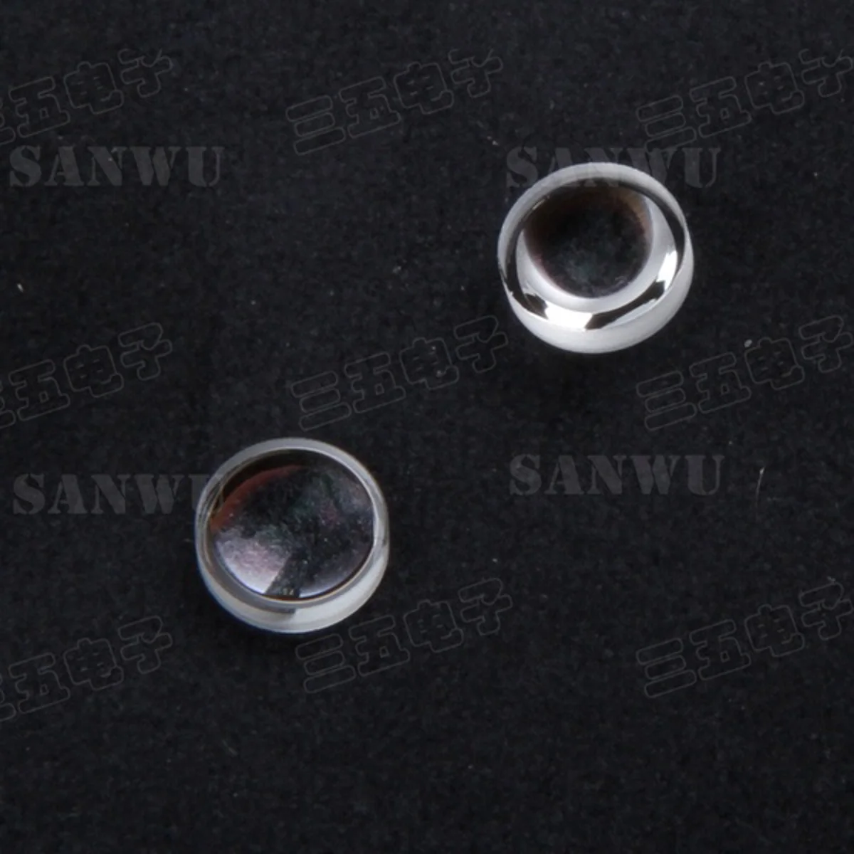

My laser chinese gatling laser and it same lens using a MP9x0.5mm lens but I need G7 lens can this lens fit my laser ?
G7 9mm holder one
Jul 10, 2015
9,521
9mm and 7mm denotes the lens barrel length when ordering from sanwu, both are M9x0.5 threaded.
What your gatling takes ?? You just said it's M9x0.5
So the G7 or G8 will fit as they are M9x0.5

G8 what is this I its better at distance or power
Jul 10, 2015
9,521
BOTH

Why G8 lens is beerer tgan G7 lens is it better for power efficiency or better beam divergence

It is better for beam divergence and better for power.
