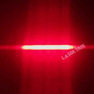

Fiber corrected 638nm laser diode find on eBAy
kecked
Jun 18, 2012
1,018
83
looks interesting. Divergence is 1:9. 1:9. Square. With no correction. It sure if this was posted before. Same group repackaging blue diodes in windowed cases with inert gas. I’m impressed.
Check with CDBEAM777, he has some of these and I believe, characterized them.
Yea I’m sending email to see if they will glue two to a pbs cube and the do a second with a blue and green. One dichro only then.
Problem I have been having with all laser diodes is the angles of their outputs are not consistent enough :( I wonder if their adding a FAC by hand might skew it even more.
I have some of these as well. The FAC doesn't really do too much once you add a collimator lens. It goes back to being a rectangle when focused.
I bought this and totally forgot I had it. I should complete the build and see how well it does with a g2 and g8 lens.
There was something that I remembered about these diodes, that for the FAC to be able to do it's job you must use a long FL lens (like, really long, enough that it will need to be larger than what will fit on a 12mm module) to allow the beam to expand enough that the profile is square when it inputs the lens, then the beam will stay square after collimation.
