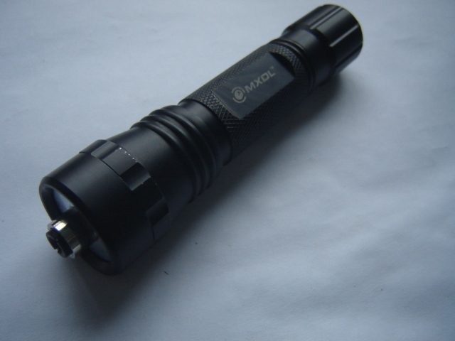

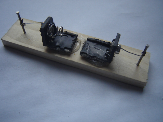

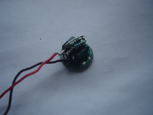

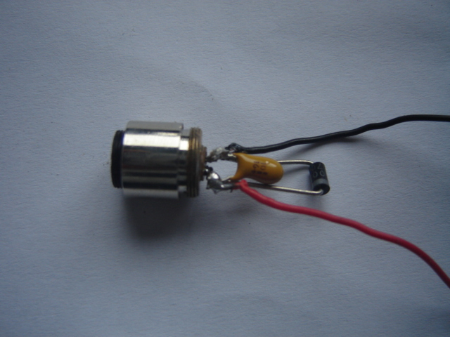

Hi guys,
Here are some pics like you asked for ;)
Normaly erverything is insiolated, but i took the elektrical tape off so you can see it better.

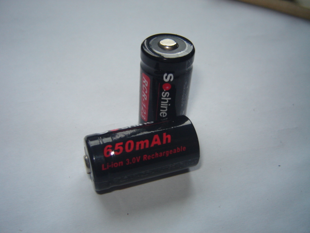

Gazoo was right about the battery's, only 5,69v together and both 2,84v saperated.
But I don't understand why the voltage is so low, because I used them beraly since I checked the voltage for the last time.
I guesse it's just some crap the dealextreme sells.
I also bought these batterys fram dx:
They are rechargeble so when thier fully charged they give off about 3,6v so I build this thing.
This makes a controlled discharge possible. :)
I'll check if everything works when both batts are 3.0v.
Greets. Yoeri
