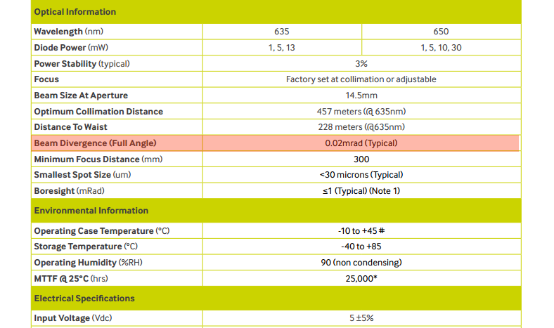

These are the lowest divergence Diode lasers I have found so far (re-branded Blue Sky Research modules)
Top notch model had 0.02 mrad divergence, IIRC.
Some DPSS could have even lower
Long Distance Targeting Lasers | Global Laser
Blue Sky Research - Home
EDIT
MiniLase OEM Modules Datasheet (PDF) >>

One of their descriptions say they use a long focal length lens. The beam diameter on a red laser is 14mm.
