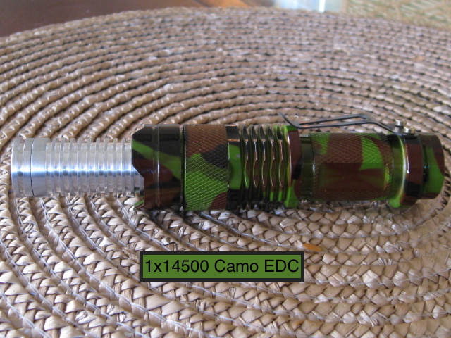

You need a host/housing for the complete assembled module with diode, driver, and lens--nobody runs just a 1500mW module by itself without a heat sink of some description because you will quickly destroy it with thermal runaway overheat. . Use a host with a heat sink for a pointer
PS a host from Lifetime17 is as good as it is going to get---excellent quality and very reasonable price

Don;t know if it was discussed yet, but there are basically 3 sizes of diode that are made to fit the 12x30 modules, so they are used a lot and for many projects, although there have been other options in the past. (Meredith modules, Kryton Grooves, DTR heatsinks)
MOST diodes you buy will be one of those three sizes (3.8, 5.6 or 9 mm) so you need the right sized module for the diode you have.
Most hosts are designed to fit these "AixiZ Modules"
I chime in on quality hosts from Lifetime17.
