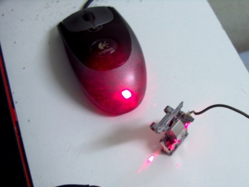

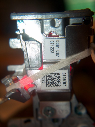

Been there, done that.
Pink 400A is not that hard to make. But because the diodes are stacked upon one another, the heat from the violet diode likely blew a hole in the red diode, which is now weaker, but accidentally exactly what I needed for pink. The divergence is not that bad if you can adjust the focus. When one wavelength is converging and the other diverging, you can project them both with the same diameter at a given distance.
I've successfully driven an LG red inside the sled, and after some modding I got it to focus at 25ft or something, not at all a bad divergence convergence. I'll definitely try this on the 803T when I get more sleds. (The pink mod too)
lots of stray ligt -- VERY dangerous! :D DON'T TRY THIS AT HOME. I WILL NOT BE HELD RESPONSIBLE FOR ANY AND ALL DAMAGE CAUSED BY THIS SETUP 8-)
[edit] it's not very efficient though. I had driven it at 275mA (would put out 150mW if it were in Aixiz with acrylic) and I could barely light a match. My guess is the sled emitted 80mW (from the main aperture)
