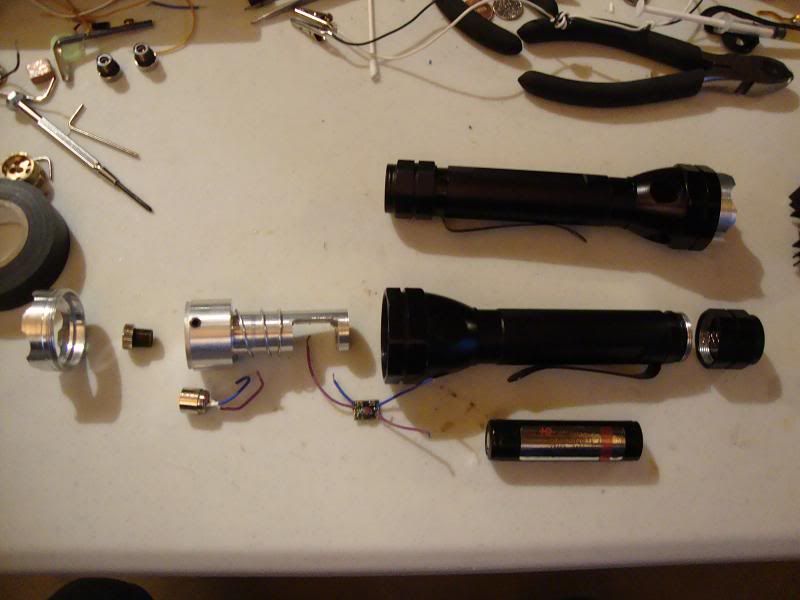

I used a Helios Kit with his custom heatsink w/ tray for the host, a DrLava V5 flexdrive set to 550mA and a 12X SF-BW512 diode I extracted from its sled - all powered with 1 18650 Li-Ion battery.
The build
The build was simple after extracting the 12X. It was just a matter of setting the diode in the Aixiz module, mounting it into the heatsink, running it's wires back to the driver, then running those wires to the battery. I also drilled a small hole in the heatsink and mounted the negative driver input with a small set screw for secure fitting. This is a case negative build and I did not use the diode case pin.
Overall the Helios Kit was great to work with for building this laser, by far one of the simplest I've ever worked with.
Pictures

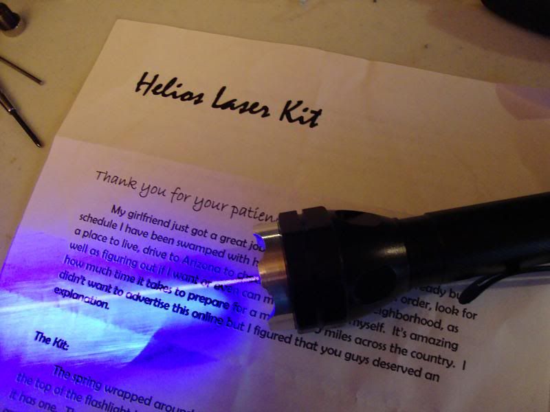

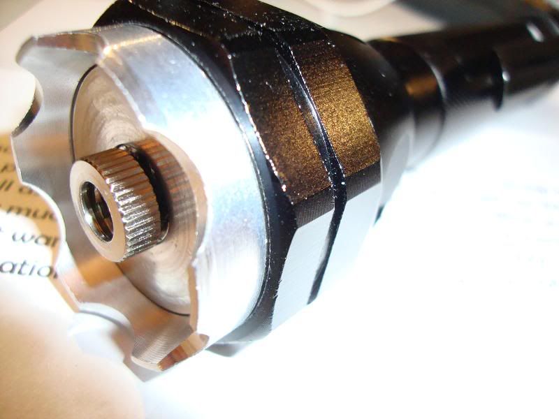

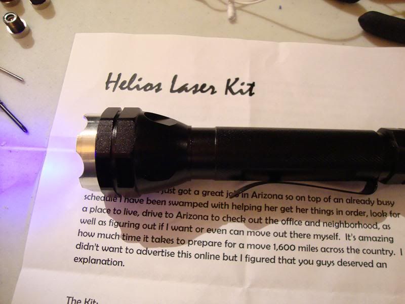

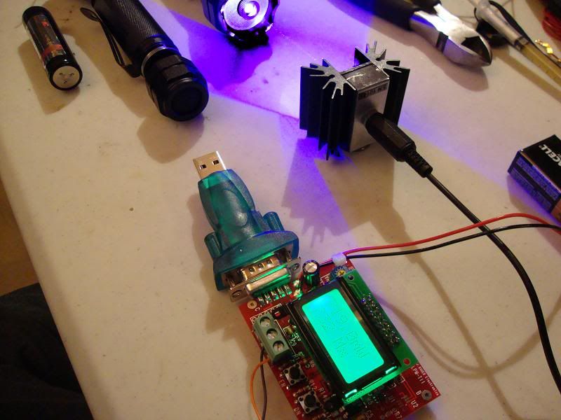

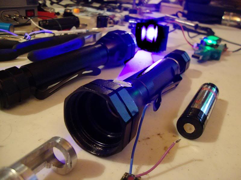

On top facing the R is the assembled laser, below facing L is a duplicate model taken apart to show its internal parts. (forgot to include the battery contact board)

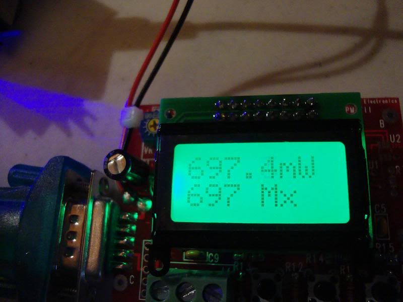

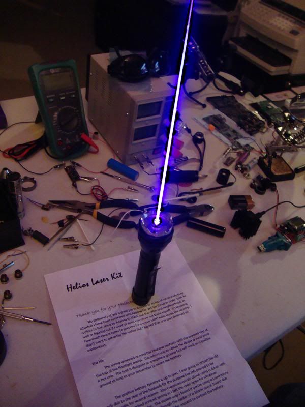

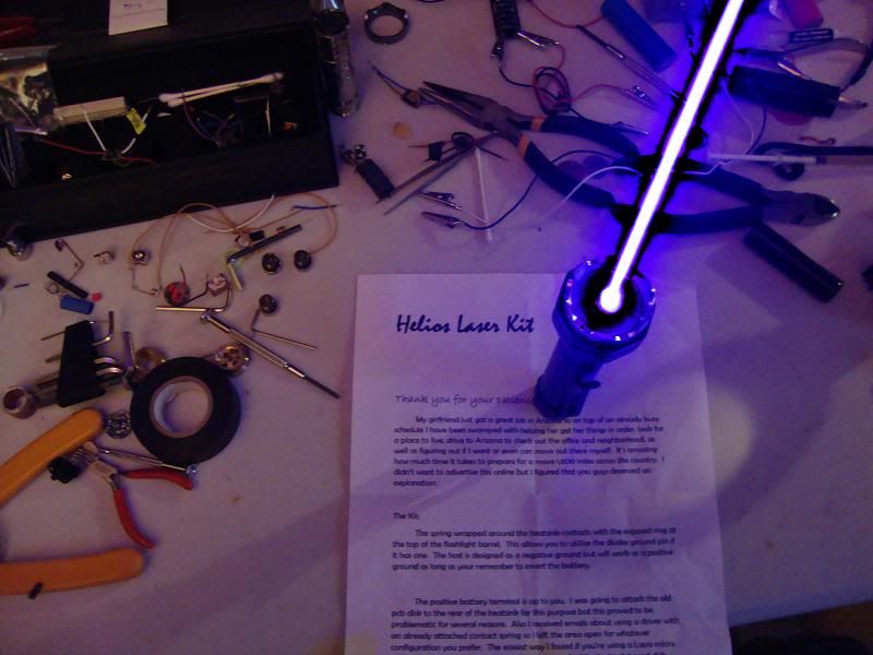

Here's a video of it in action.
Part 1
:D

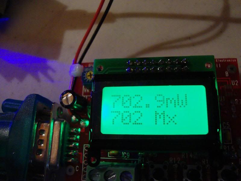

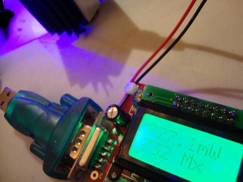

I shut the laser off at 697mW, then turned it back on to snap some more pictures and it metered even higher.....
Part 2
