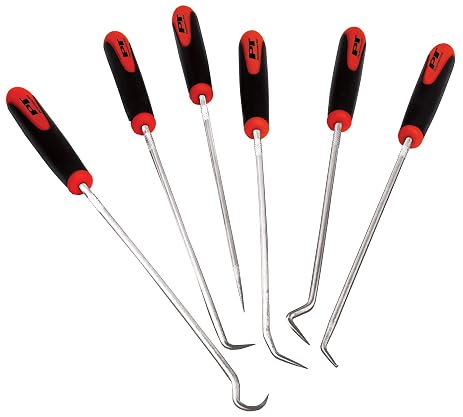

I have some of these, though I didn't need them, torque was enough to get the cap free.
Be very careful about scratching the lens if you plan on getting something in there as there is very little room between the lens and the cap
