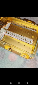

I received the 500W pump today. From what I see, I will need to drill the outlet here too.

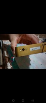

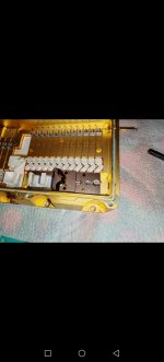

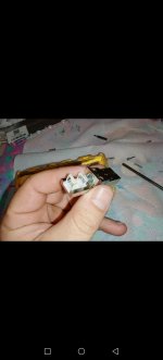

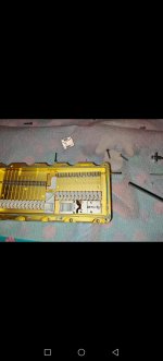

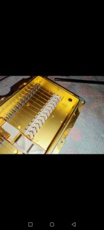

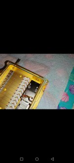

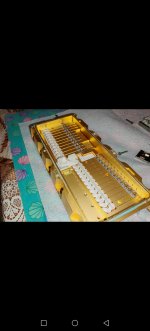

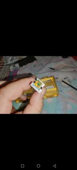

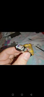

This 500W pump is different from the one in the video. I opened it and there is a difference in the fiber grip. Fortunately, there is a hole and I may not have to drill further. I removed the metal part with the lenses and the fiber. It turned out that the two lenses after the cube are glued to the metal part of the fiber. This is good because I will not have to break them. I can't test it right now because I am not at home. I will write when I do. This 500W pump is definitely very easy to remove the fiber.
