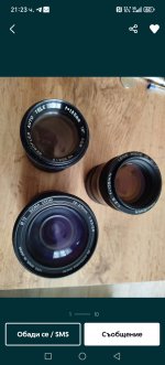

Yes, I saw I saw them on Aliexpress. Now I need to add a 5mw red laser to show me where the beam is pointing. That way it will be easier for me to experiment with the lens I have. I also found an ad currently selling a side of 3 lenses. He sells all three for $35
  • Screenshot_20250227_212333_com_sirmamobile_prodavalnik_GalleryActivity.jpg

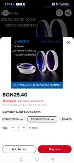

I ordered this lens with 800mm focal length. I hope to achieve a good burn.
ZNK Fiber Laser Collimating Lens Focus Lens D16 F60mm D20F150 Quartz Fused Sillica For SUP20S/21S/21C/21T Laser Cleaning
  • Screenshot_20250228_171443_com_alibaba_aliexpresshd_ProductSKUActivity.jpg

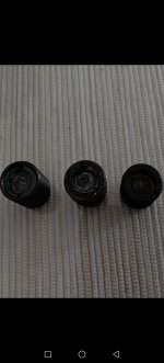

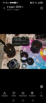

Today I bought these three lenses for 35$. The lenses are like new. I took them apart and removed the lenses. I left only the front ones with the option to adjust the focus. I will do tests when I have time. So far I've experimented with a green laser and things are working out pretty well.
I did some quick tests with the lenses from the photo lenses and things are working out fine. When I have more time I will start making lenses from PVC pipes. I will try different combinations with the lenses because there are many and decide which ones to use
