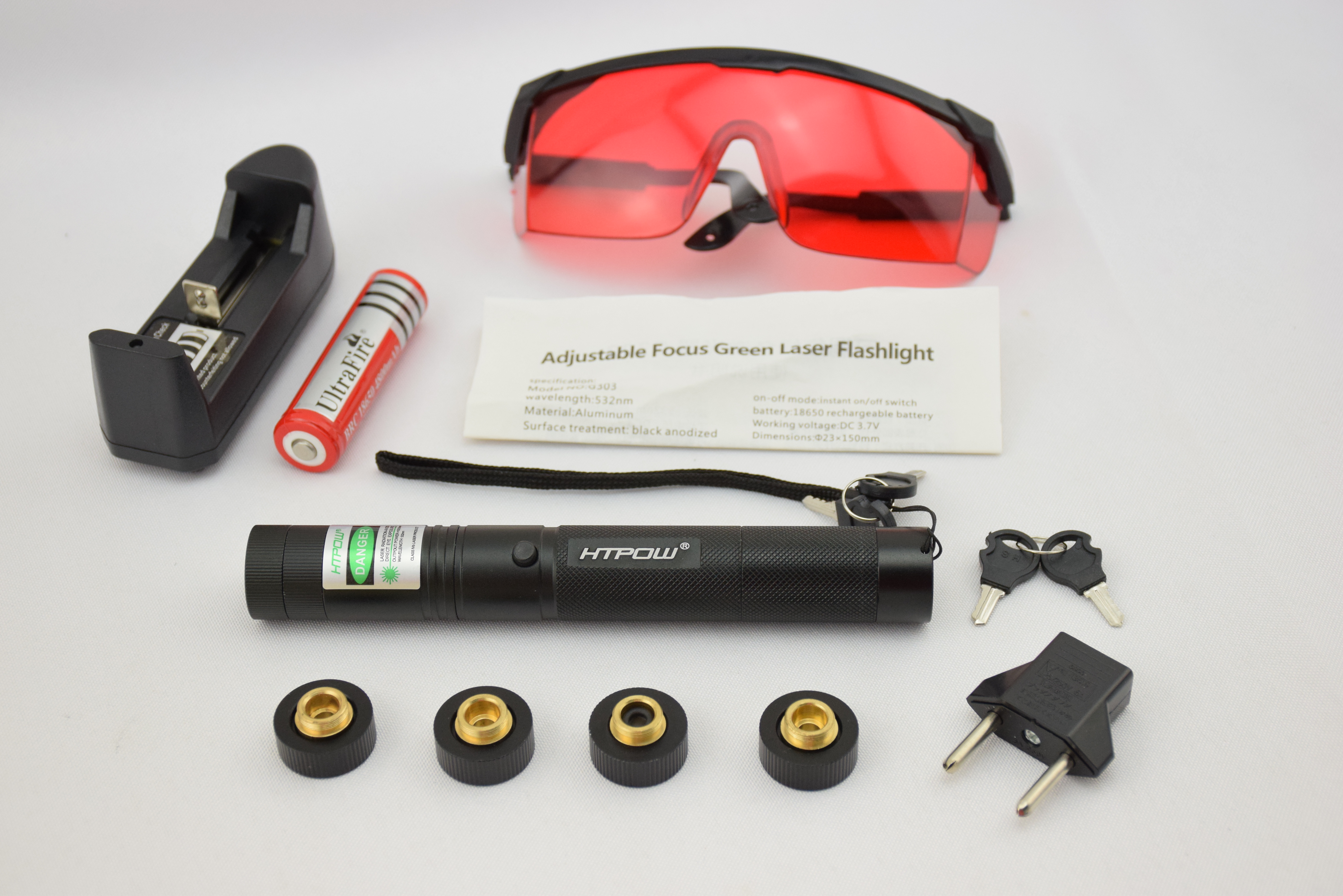

Is it the same as this laser?
It'll take lithium ion batteries numbered "18650".
Take a look around the forum for those, I think there are a few members selling some good cells for cheap prices.

Pictures would help. Is it a pen style, or is it thicker?
Pen Styles usually use 2 x aaa
The thicker ones usually use a 18650...
Although I believe the SD models are usually 18650
