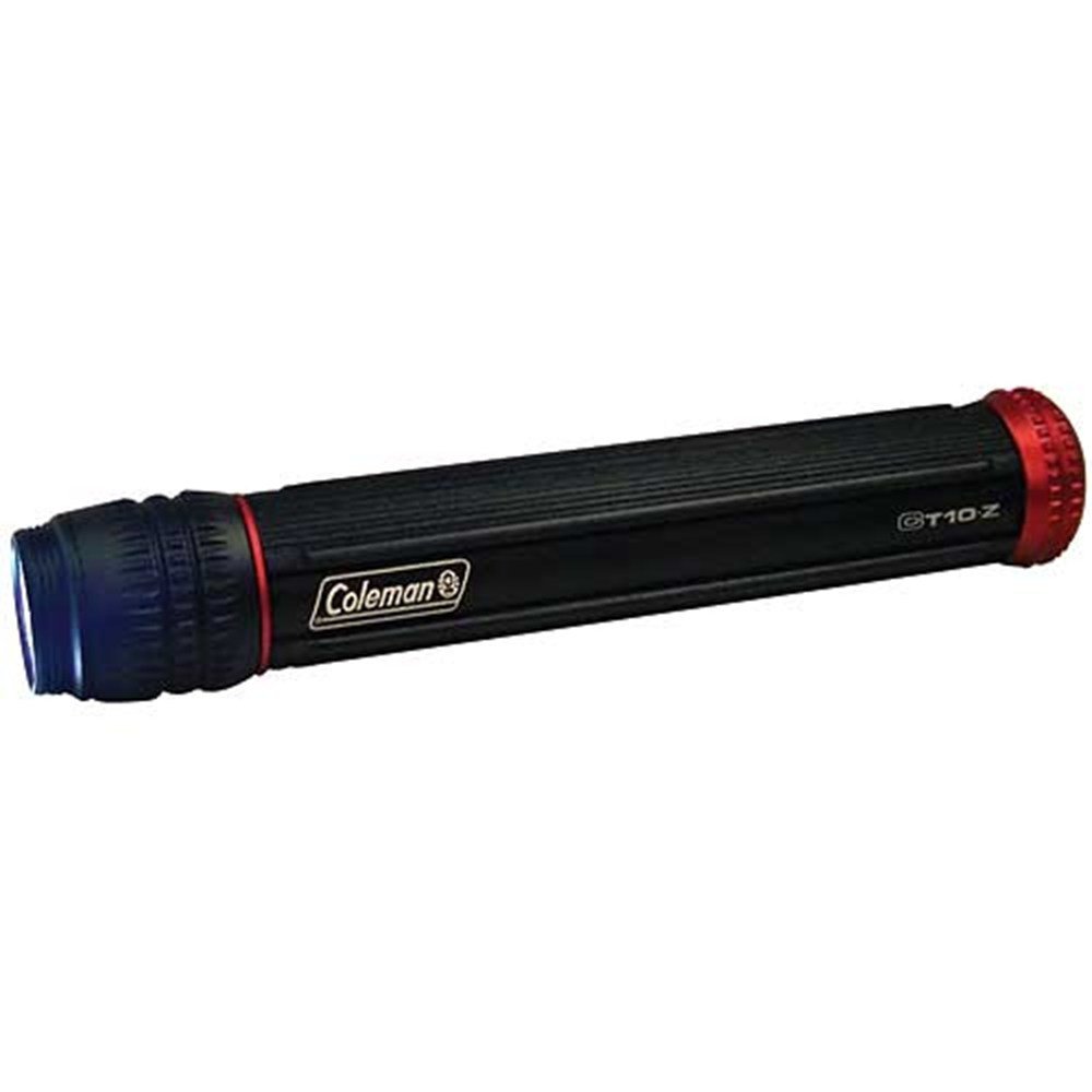

Walmart didn't have any or I couldn't find it so ended up with a red one from Target as they didn't have any in green. They are now labeled as 70 lumens and thus the CT7 label on the side:)
Hmmmmm maybe I read something wrong as I looked at your first post and it doesn't say there's a green trimmed one. Looks like I need my strap wrenches to pop the top.
Having trouble even with my strap wrenches getting the top to loosen. Did you have to heat it?
Forget it. Got it but it is glued. Don't know if the CT6 was or not but I had to use serious torque to finally crack it loose.

Mine came apart very easily; I took mine apart in the car before I even left the parking lot.
They have obviously updated them to the "pain in the butt" version. Honestly, I thought I might actually break one of the strap wrenches. I did not try heating it though as I didn't want to chance messing the host up. I can easily see someone ruining theirs trying to get the head off. The threads are actually completely covered with glue and not just some tack spot of it. Fair warning has been given.
I believe Harbor F sells some strap wrenches pretty cheap and they are really ar geat tool to have for lots of things.

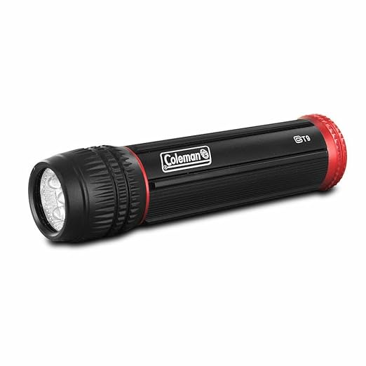

I forgot that they are also now black instead of grey. Looks very sharp with the red trim. MUCH better looking in person as BTG's pics show.
They make different output ones that use the same host so this would likely be an 80 lumen.
They also make ones that use a couple AA with the same look that would probably be easier to put a module in.
I'll see what Walmart has on this one as I have to go there tomorrow (Picked up the wrong curling iron for my wife) but both of those cost about $16 on Amazon if you get the lowest powered ones. They look like plastic in the pics but are all aluminum and great finish.
