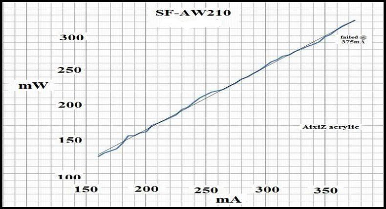

i bought i 405nm diode on ebay for 25$, they advertised with 300mW.
i don't worry about it, i payed with paypal and if the diode won't reach 300mW i'll get my money back. it's from a chinese dealer, they'll do anything to keep their good rating.
but what current is safe to pump through the diode? i think 300mW of output is a bit overestimated.
this is the graph on the ebay page, i think it's a bit too positive.

Yeah you can get 300mW's, but it won't last long...
That graph from Dave was when we were testing and pushing them...
A safer current is more like 170mA's...
This will give you about 200mW's with one of my 405-G-1 glass lens modifications...

wow from what ive heard they die too quickly at anything over 200ish... way over stated. its the 4x bluray diode right?

See that "wiggle" in the line inside the circle? That is what is known as a "kink." In order to keep those diodes burning for the long haul, you have to keep the current BELOW the kink. For the SF-AW210 that means BELOW 185mA
You see that white block under the "SF-AW210" label? That's where they deleted my name :gun:

Why? You paid a decent price for it at $25. Those diodes are sold elsewhere for around $28.
If they advertised it as a 12X then that's a different story...
I think you should just keep it. It should work fine at 160-170mA.

It is definitely worth $25. Just run it at the correct current and have a nice 165mW laser.
If you want 300mW, you're going to have to spend a lot more money and get an 8X (~$160)
