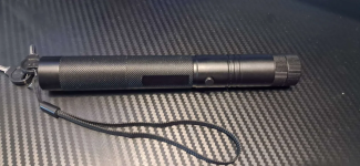

Hi, I recently bought a 1600mW laser from Sanwu Lasers but it doesn't work.
(I have 2x 18350 batteries) and unlocked with key
(It come without any watermark and warning sticker, i dont know if it's good or not)
(Looks like the batteries were not big enough to touch each other haha, I temporarily replaced them with aluminum and the laser works)
I'm curious, can you explain it better?
The batteries are made in such a way that they do not touch each other, so there must be aluminum or something else between them that conducts electricity
Reactions: GSS
Must be flat tops, get a small circle magnet those work great for this instance.
Reactions: GSS
That’s a Sanwu? Looks like an SDLaser 301.
Yup, Sanwu modifies the 301 hosts with different WL's and power..
or tests and bins the regular 532's that measure 80mW and more and sells them.
Currently, I have glued a small element on one of the batteries that helps the batteries touch each other, so I don't have to worry about losing the magnet.
