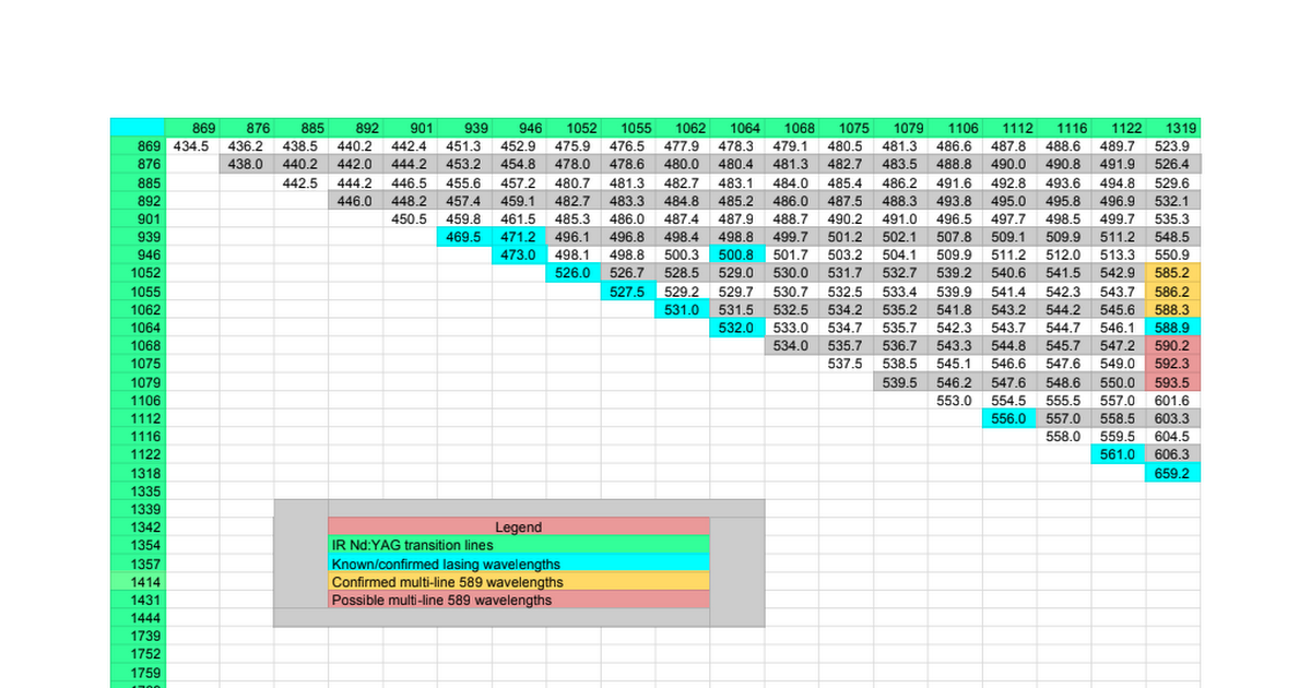

[Request] List of wavelengths that are created from dpss lasers
Are you kidding me? That is a very long list. Try searching for all DPSS laser wavelengths. Just in yellow, and off the top of my head, these include 565nm, 575nm 577nm, 589nm, 593.5nm, etc.

Ah interesting. Is there any reason why the advertised wavelengths for DPSS lasers are more accurate? This is interesting. I never noticed how diode lasers are always in increments of 5 because of the batch error.
Yes, It has to do with the Neodymium expulsion wavelength as being ~1064nm. Double the frequency of that to 532nm and there you are. The most frequently used doubling crystal is potassium titanyl phosphate, or KTP.
Yeah. DPSS technology often has more precision because the crystals involved fundamentally can only emit certain wavelengths of light. There's still a small range to it, but truly not much. Diode 808nm +/-5 -> Nd:YAG -> 1064nm -> KTP -> 532nm
Plus the doubling itself cuts down the margin of error. For example it is possible to directly double a diode. If the diode is 1000nm +/- 5nm you'd see 995nm-1005nm. Double the frequency (meaning the length between the waves is halved) and you see 497.5nm-502.5nm --- 500nm +/-2.5nm.
