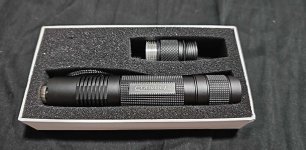

Custom builders like me give you a 470nm 8W+ for 300$ convoy s8 host just uses x1 18650 or x1 18350. G8 or G2 shorty lens included. No battery included.
received_857990335740390.jpegFB_IMG_1694861493074.jpgFB_IMG_1694861488896.jpgFB_IMG_1694861484757.jpg
