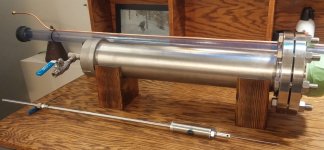

Here's the cannon :
The 'popper' needs to be inside that stainless helium tank, or isolated with a window or something.
The mylar burst disk is held by the flange assembly.
My air cylinder should be here tomorrow.

Here's the popper.
The 3/8" tube assembly with the cylinder goes inside the tank via the 'tee' assembly at the back, it's coaxial.....
Tank fill is through the side port with the valve. The trigger is done with the straight through tube...Trigger is tank pressure+50Psi.
The pointy bit is a TIG tungsten.
