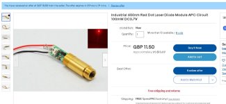

I have found a 100mw RED laser with driver (see picture) but because I'm new to this I don't know if that thread is a standard for lens/holders also if the G2 lens is appropriate for what I want (simply close focus and nothing more I think! Unless someone is going to say “wavelength” for RED,GREEN and BLUE lasers)?
Whilst creating anything I spend more money developing it than the actual final version, this is why I'm asking so many questions to save myself money, as I can't afford £500 just to finally find the end result costing £50.
Yes, as RedCowboy says I can buy the FC lasers complete but that total cost is £250 just for the lasers then 10m of the fibre is £140 excluding all the other electronic bits.
Ideally someone can say "here, use these R,G,B ebay laser, with these lens’s and holder, total £xx get someone to machine a small FC end piece and your sorted”
I can 3D print all the holders for the PCB etc and make the electronics myself.

Your edge emitting fiber is pretty thick isn't it ? Something like 3mm - 8mm .....if so I would test just shining the laser into the fiber and see what you get, if acceptable then make or 3D print a holder......of course you can experiment with the lens focus.

The core is 170um the outer is 1mm thick approx, thats why I think they use FC connectors. but maybe I'm over thinking it.
Do you think the laser in the advert picture would be able to focus on a 0.17mm fiber at a resonable distance (max 10mm)?

170um side emitting fiber........why so small ? OIC that's how they get away with low power lasers.
A laser in theory can be focused down to it's wavelength, in practice not so much, that said a 100mw 650nm is not going to be very bright, I haven't used one with side emitting fiber but I have illuminated all kinds of materials and 100mw of 650nm is unlikely to satisfy you. 638nm is much more visible and I expect you will need more output, but maybe buy yourself a cheap laser and do some testing.
