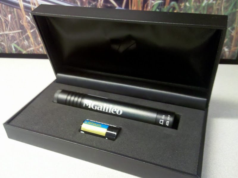

This isn't intended to be a review... but here are a couple of photos of the packaging and laser.
Packaging:
Display Box, Closed:
Display Box, Open (note, the battery in the box is not the one that the Galileo came with):
Label:
Thanks for looking!
Packaging:
Label:
Thanks for looking!
