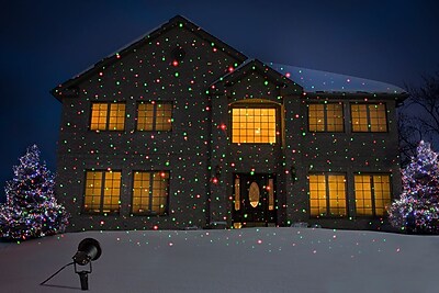

Your best bet would be mounting one of these on the robot. These are designed to diffuse the light and make it safer.
m003107272_sc7
