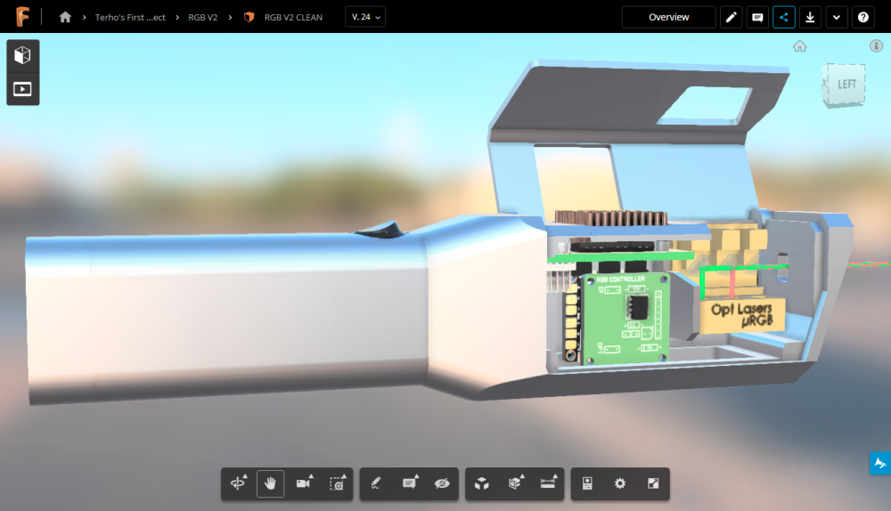

We will need to make few minor changes to design, since you have different size / type driver PCB and MOSFET's are in 90 degree angle.:thinking:

I couldn't find your diver mounting hole raster from OptLaser site..

Since you own a 3D printer we could make few VER2 design prototypes and after succesfull 3D prototype we could ask if trinh hong phuoc could mill Al version of it? It probably dosn't cost too much from him..

You could try to print V2, I'll just need some time to finish the design.
But since you have 3D printer we can do tweaks on the fly..
RGB Ver2 >>>

V2 looks cool, but Id have to print it in parts as I can only print max 20 x 20 x 20 cm. 15 x15 x15 cm would better though, as bed levelling is a b*tch and difficult over the entire xy plane.
