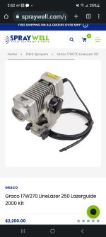

I'm going through this idea of making a more affordable laser guide system using a 5.0V 4x18650 battery pack and the laser in question. Both will be mounted to the painting machine. The company who makes the paint machine (graco) sells their own laser for over $2k which seems ridiculous because the specs on that is just a 24V 5mw laser powered by a deep cycle motorcycle style battery that mounts to the machine as well.
