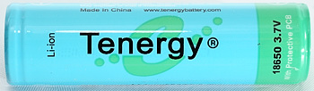

The Tenergy 2600 protected (cyan) is 66.7mm long. It fits fine in my Arctic.
