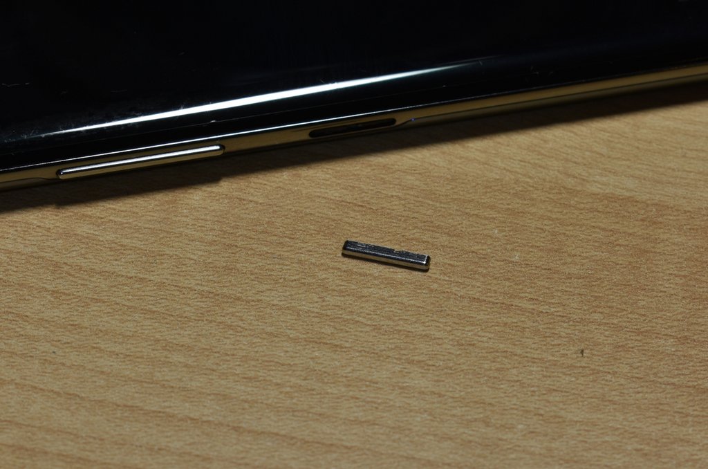

Anyone here have this phone and had a similar situation? It just randomly fell right out one day. Thinking maybe I could super glue it back, but it's such a small piece, glue could easily get into the button mechanism if I don't get it exactly right.
Some pics of the problem:
The tiniest amount of an Epoxy resin or contact adhesive on the end of a toothpick. You want to put the smallest amount dead centre on the button so when you press it on, the glue only spreads so far and not onto the surrounding metal. I would recommend superglue, but make a mistake and you're finished. At least with the epoxy/contact adhesive you have some play and can scrape of the glue before it sets if you make a mistake.
I had a similar issue on my Redmi 3 pro a few years ago. Stuffed some paper inside so my fingernail can press the switch inside.
Other alternative would be to glue the plastic piece back with a glue that stays relatively soft after drying (e.g. UHU glue).
As long as you get the superglue perfectly positioned, it should work
But if you mess it up you'll need to give the phone an acetone soak which might ruin plastic (if there is any, if not no worries)
Best to avoid using the superglue altogether and use a safer alternative.

I have to say I am really not impressed with the quality of this device. For such an expensive phone, the piece of the button that fell out feels cheap and fragile and unfortunately the whole switch seems to be a bit messed up. Even when I put the button cap back in, it doesn't have the same click it did before and won't always press properly.
I have had other phones break before, but only because I did something stupid like drop them or get them wet. lol This is the first one I have had just break for no reason and it happens to be the most expensive one I have owned. (n)

Apparently you are not the only one having the switch problem-
There are a lot of listings on eBay for replacement Note10+ power and volume buttons for $5 to $10
Should be simple enough to replace it with a fresh one if gluing doesn't work out.
See: https://www.ebay.com/sch/i.html?_fr...570.l1313&_nkw=Note+10++power+button&_sacat=0
I think I'll go for the full replacement, thanks for the link. Too much risk with the glue that I could ruin the phone, not worth the risk when I can get new buttons for $5.
Found one for even less:
Does seem that this problem is not that uncommon, with the amount of sellers offering this part, and the number of repair tutorials I have found.
