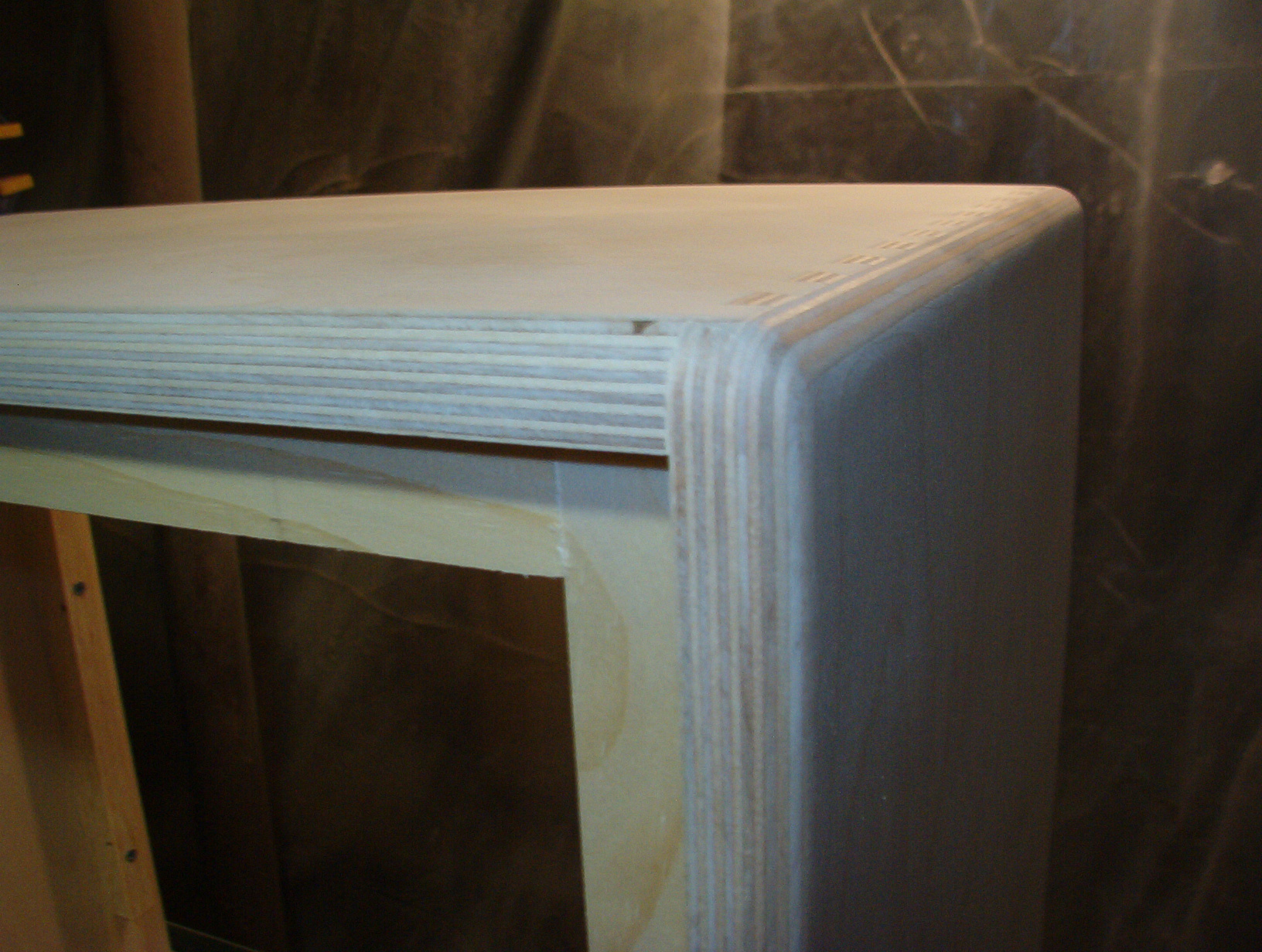

Have you considered Baltic Birch ply? When finished, the edges have a very nice appearance due to the type of material. It's ply but cosmetically it looks very nice, even the sanded edges. Baltic Birch ply is unique and much higher quality than standard plywood, layers are made from veneer rather than some of the more pulp type of layers in standard construction grade plywood. Google some images of finished Baltic Birch edges. 3/4" is available but not too easy to find in some place, 1/2" is much easier to source.
Just a thought because it is very straight material unlike regular types of common wood that warps. Be careful with using regular wood, even kiln dried can start straight and unwarped but quickly end up changing shapes on you with the slightest variance in humidity and temperature. For things that must retain their shape, regular wood can prove to be very difficult to work with. If you don't like the idea of ply edges showing, even the BB mentioned above, consider a veneered plywood and use a veneer tape to cover the edges.

Oh wow that looks nice!
