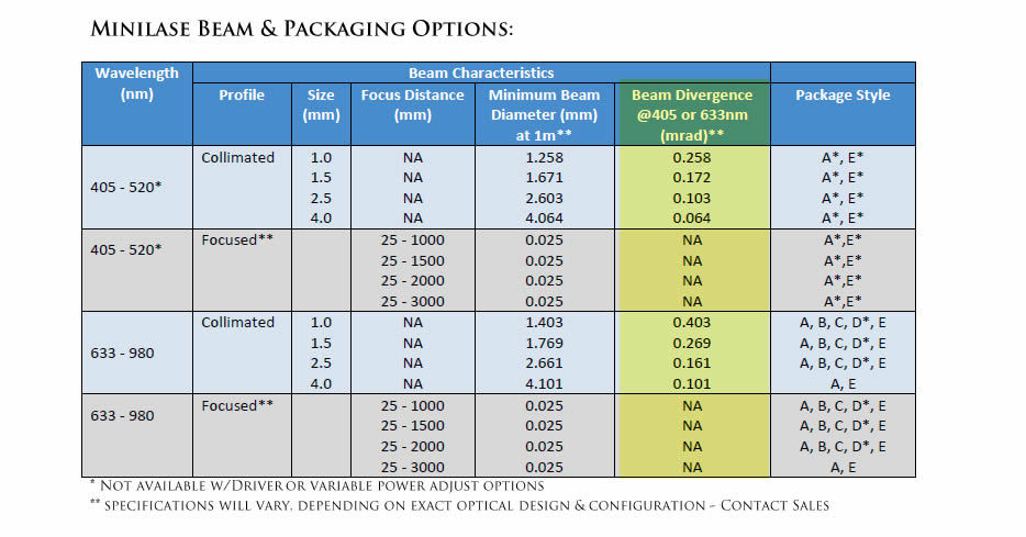

Those VIS 405-520 beam divergence specifications are uber low, whether they are using the full or half beam width calcs.

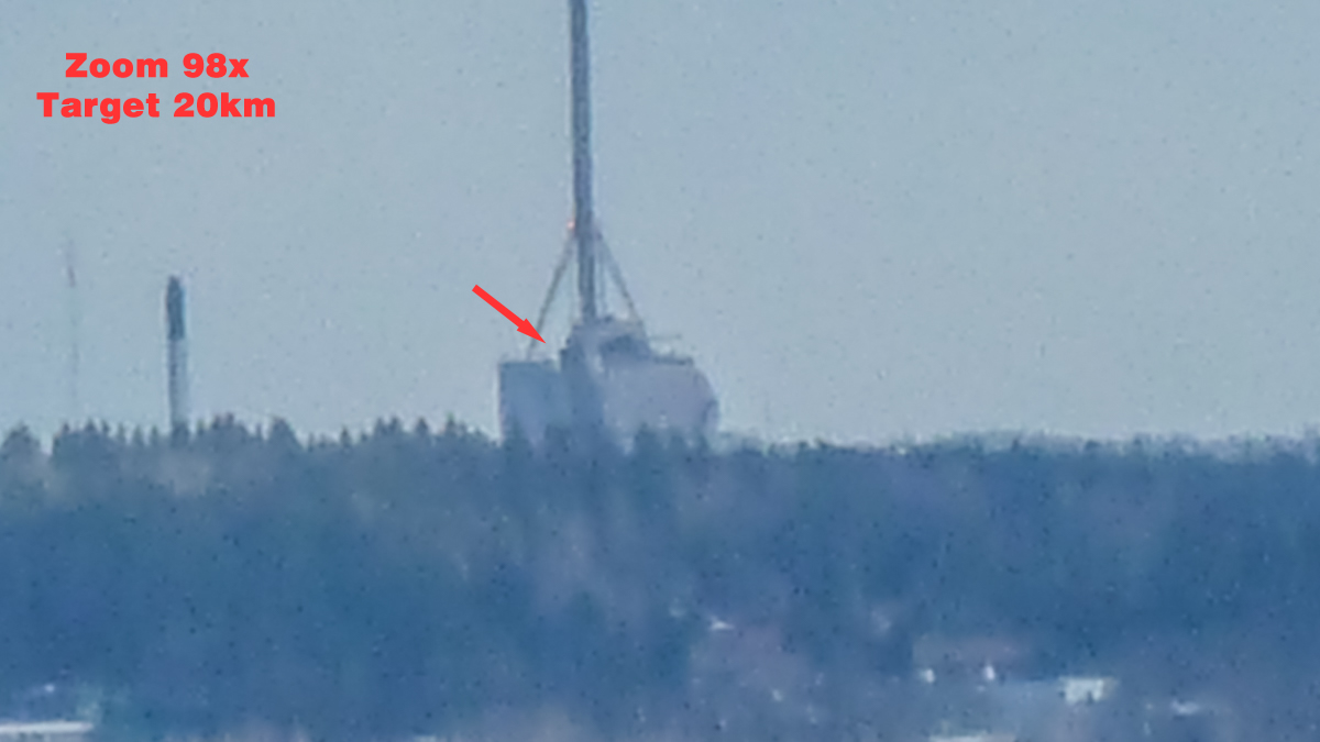

I have found location where I can do 20km pointing / "experiment" in very safely way.
I'm looking diode for doing that.

Collimated 520nm MiniLASE module with 4mm beam profile would be 1,3 meters at 20km distance without any beam expander.. :thinking:
I believe you are right on the price of these diodes in their modules. They claim an M2 value of less than 1.3, which is still Gaussian. Not at all bad for a diode based laser.
The smaller the emitter, the lower the resulting divergence. Single mode diodes have small emitters, but unfortunately, that also limits the power they produce.

That looks uber nice and I am sure, $$$. On that target you zoomed to, are you going to use your single mode laser and put a spot on it later? If you do, a pic would be great :)
See post 5. Check one of his other thread(s). In that one he does long range spotting with photos.
