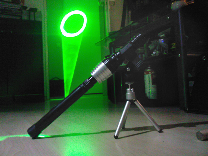

Ok, I take a plastik tube which fit with some hot-water-modding, thight, on my aconsen 450mw green Handheld build.

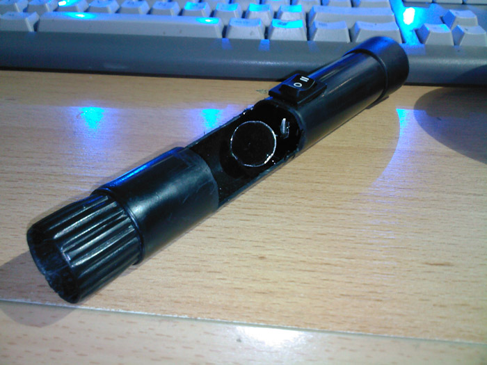

Take my dremel and cut two windows in it.
One to put the motor in it, the other one for the switch.
Motor is from cheap mini helicopter, and runs great @ one AA.
AA is in a proper holder and enought wire to shake it out for change.
Mirror is selfmade from harddisk, an glued with 5 minute epoxy.
End cap is a chair leg cap from do-it-yourself store I have in stock.  ;)
Its for 25 mm and i have 25,5mm.
I just boil it in hot water and press it hot on the barrel.
If its cooled down the Cap fits tight but batterie will last forever i guess.
The motor is fixed with hotglue, no mercy!   ::)
Add Tripod and have fun lasing tunnels.  8-)
Ready!

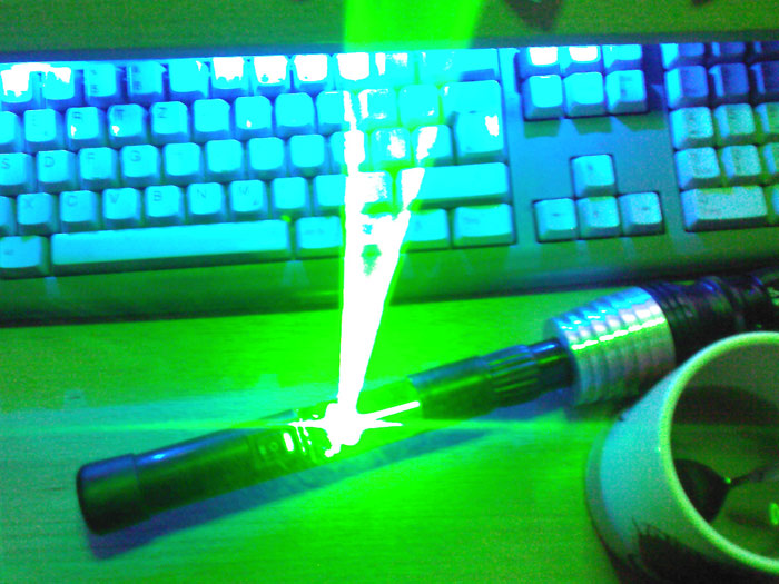

Can you come out with some diagram how you construct the motor and mirror part? I am very interested in doing something like this, small and portable, neat!
Its nothing difficult just a circuit with the batterie holder and the switch in series.
I put the motor with the mirror in the tube, and shine the laser on it, when i found good position i put the heat glue on it.
Ready.
It must not look like that, different tubes and boxes are usable.
