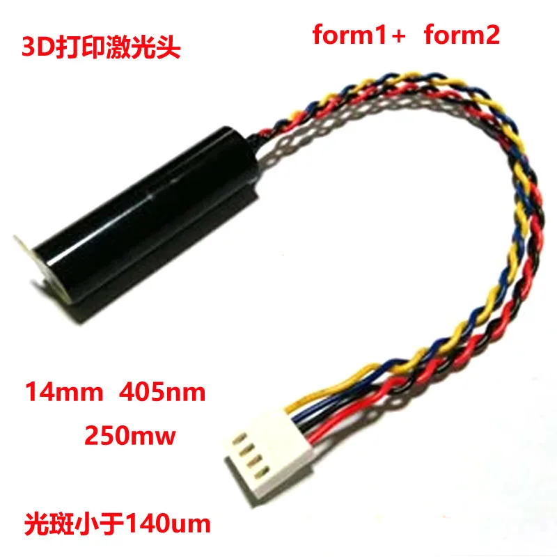

im pretty sure the diode itself not more then $100 worst case. As i checked online similar diodes around $20 or so.
closes i could find online for a ready module is this, but kind of risky specially when seller not even respond to my PM
also this order would take 30 business days with fastest shipping
Smarter Shopping, Better Living! Aliexpress.com
www.aliexpress.com
this module compatible with form1 also, thats why has integrated PD inside of the diode.
form2 model not using PD. (you can see it on my pictures only 2 legs connected on PCB)
