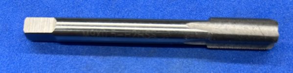

As far as taps, you would need a special bottom cut tap that you won't find at a normal hardware store. They are used for bling hole tapping when the tap can't go all the way through a hole.
Note the tap at the bottom of the photo is more blunt nosed. There must already be threads cut using one of the other two taps, which are both slightly different, and then finish up with the bottom cut tap. You can also grind the nose even more blunt to get deeper in a bling hole.
These are from Travers tool Co. McMaster Carr is also a good source. Maybe a good ace hardware but never seen them.
You're not going to find the correct tap at Home Depot.... The modules us an M9 x .5 thread and an M11 x .5 thread.
