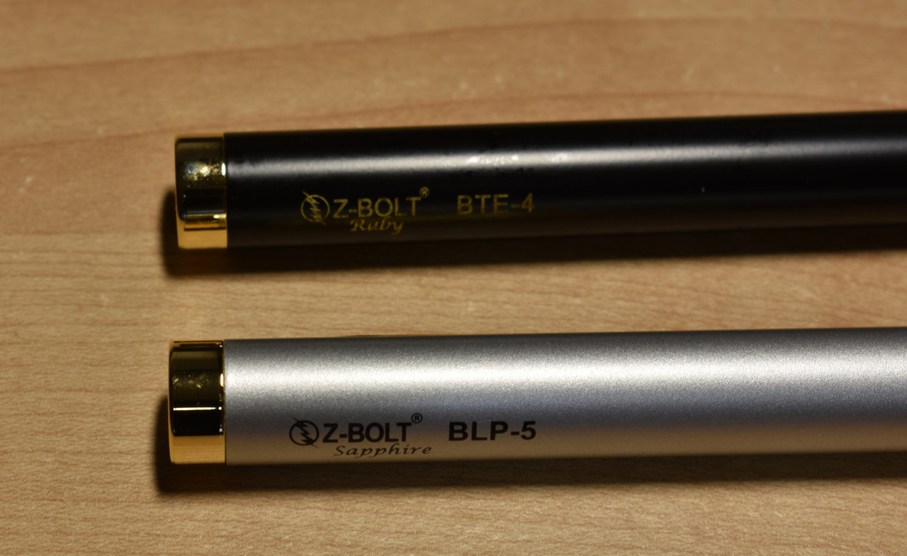

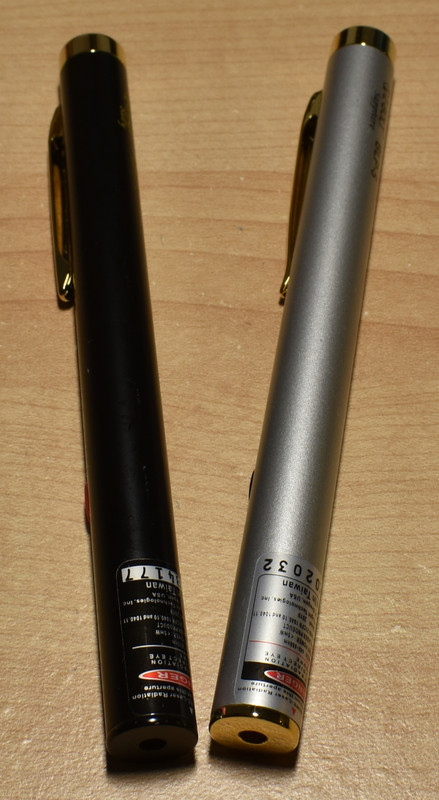

Yeah, the ones from Z Bolt are really nice. I have a 5mW red and blue pair of pointers I got from them. Z Bolt and also LaserGlow are the best options for high quality pointers that are actually less than 5mW.
