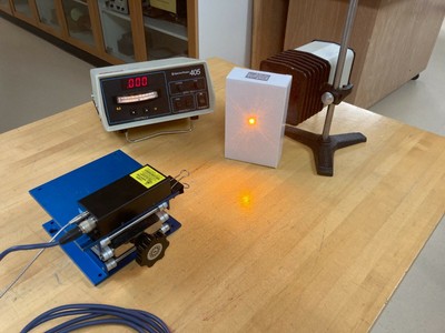

uhh i think i found something
they have a lot of nice stuff but too expensive for me. I also want more in the 575nm range.
