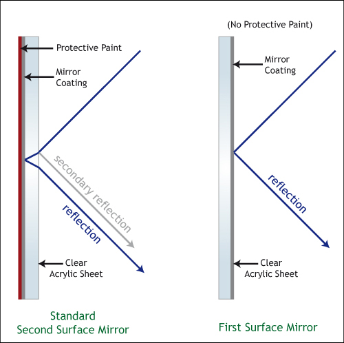

9A3DAA, is it a first surface mirror or a plain old second surface mirror?
Note: You can have internal reflections with the rear surface mirror, though the diagram doesn't show that.

9A3DAA, is it a first surface mirror or a plain old rear surface mirror?
It is rear surface mirror
Everything perfect clear now. Thanks for help. :thanks:
Yup, that's likely what was causing it and why the lines weren't rotating when you rotated the mirror.
