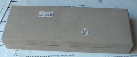

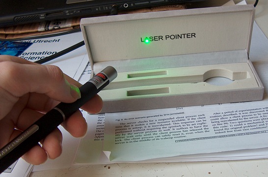

Yesterday I received my DealExtreme "True Wish" 50mW. At $25.45 it's a quarter of the price as a quality WL/etc laser.
(I'll highlight the some keywords that summarize the laser)
I must say I have never been this happy with any laser buy! (technically my only other "buys" are 5mW'ies if you don't count buying a DVD burner for the sole purpose of extracting the diode, twice)
The gift box is plain suede and the foam inside smells.

the laser int he photo seems not to be so shining.......it seems a 5mw......
