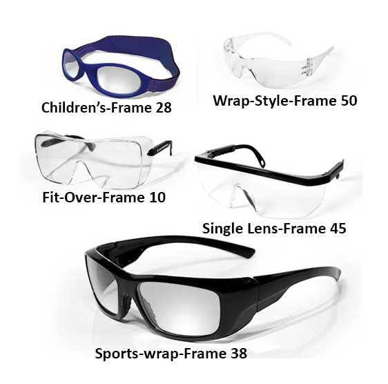

A good pair of laser safety goggles, not just glasses are needed because of the gap at the bridge of your nose and peripheral exposure hazards, you want goggles that make a face seal and your device needs to have an "ON" indicator light to let you know it's powered on and you need an aperture shutter, even if it's just a brick of piece of angle iron and be in the habit of using it.

I feel the same way, the safety goggles that seal to your face are a very good idea.
Also I use shrouds and lens flare hiders on a lot of my visible units, you really want to have a clean beam with IR so the camera with IR filter delete is a needed tool as well.
Survival lasers has some ir glasses with the side curtains and nose curtain, these are the least that I would use.
P.S. I know OP said he has/uses FPV camera goggles, but having normal attenuation type goggles are also a good tool to have, plus you should have extra protective eye wear for when you show your device to someone else, which you likely will.
