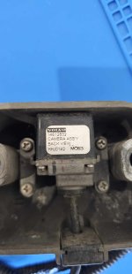

Hey guys, I m Trying to find a boost converter to power a reverse camera for a vehicle. The OEM was burnt. The Vout of the OEM system is around 7.8v and I bought a few sensors to test from Alie but all of them are 12v. Any reliable solution?

7.8V is the voltage coming from the OEM display of the vehicle. Not the Vehicle 's voltage. The vehicle itself is a 24v excavator!
Got it....
-The Original Camera worked on 7.8VDC
-The Original Camera is DEAD
-You want to use an Off the Shelf 12VDC Camera to replace it.
Try a Step Up Boost Converter like this:
