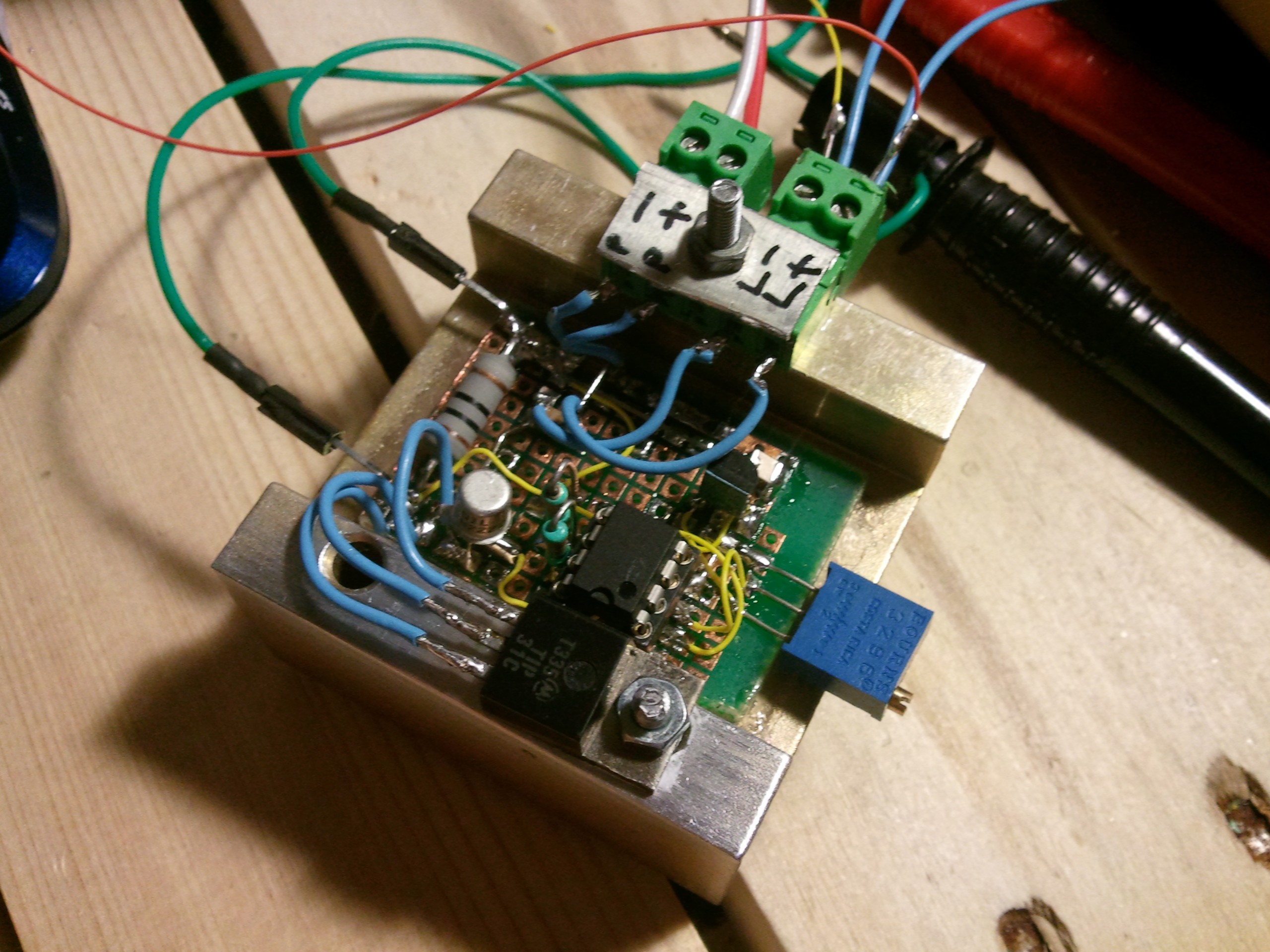

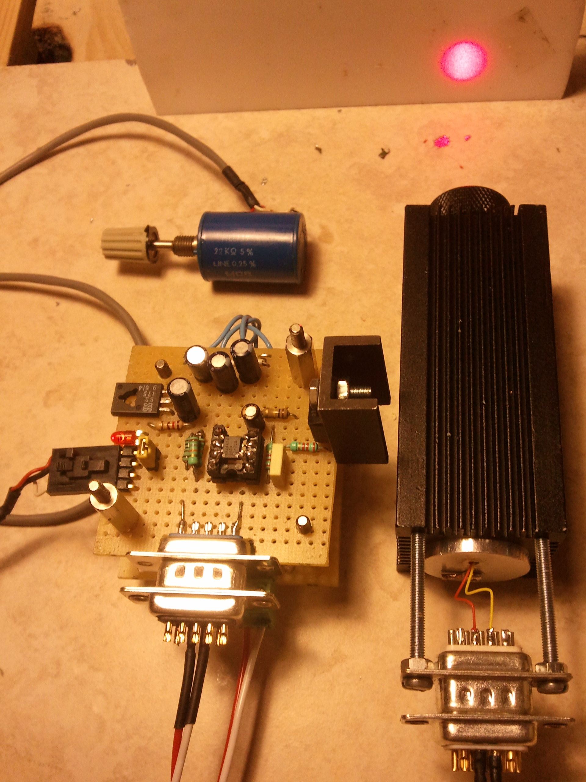

So here I am, I now have a working driver using a soft-start circuit, a maxim rail to rail "precision" op amp, a n-channel FET instead of a bipolar transistor, and the same potentiometer. I added RC networks in a few places to prevent transients. The current is limited to 80mA because of the 8-Volts regulated supply. The new dvd burner red diode I tested with this driver is still alive
So, I have another question here:
The soft start circuit is strange. Input is 12V, but output is 9V... It worked when I tested with a simple LED, but now the transistor does not seem to saturate when I connect a LD. I think the BD175 transistor does not have enough current gain so the base current is not sufficient to turn the transistor full-on? I used a 33K resistor and a 47uF capacitor to have plenty of startup time. Would a darlington solve the base current problem?

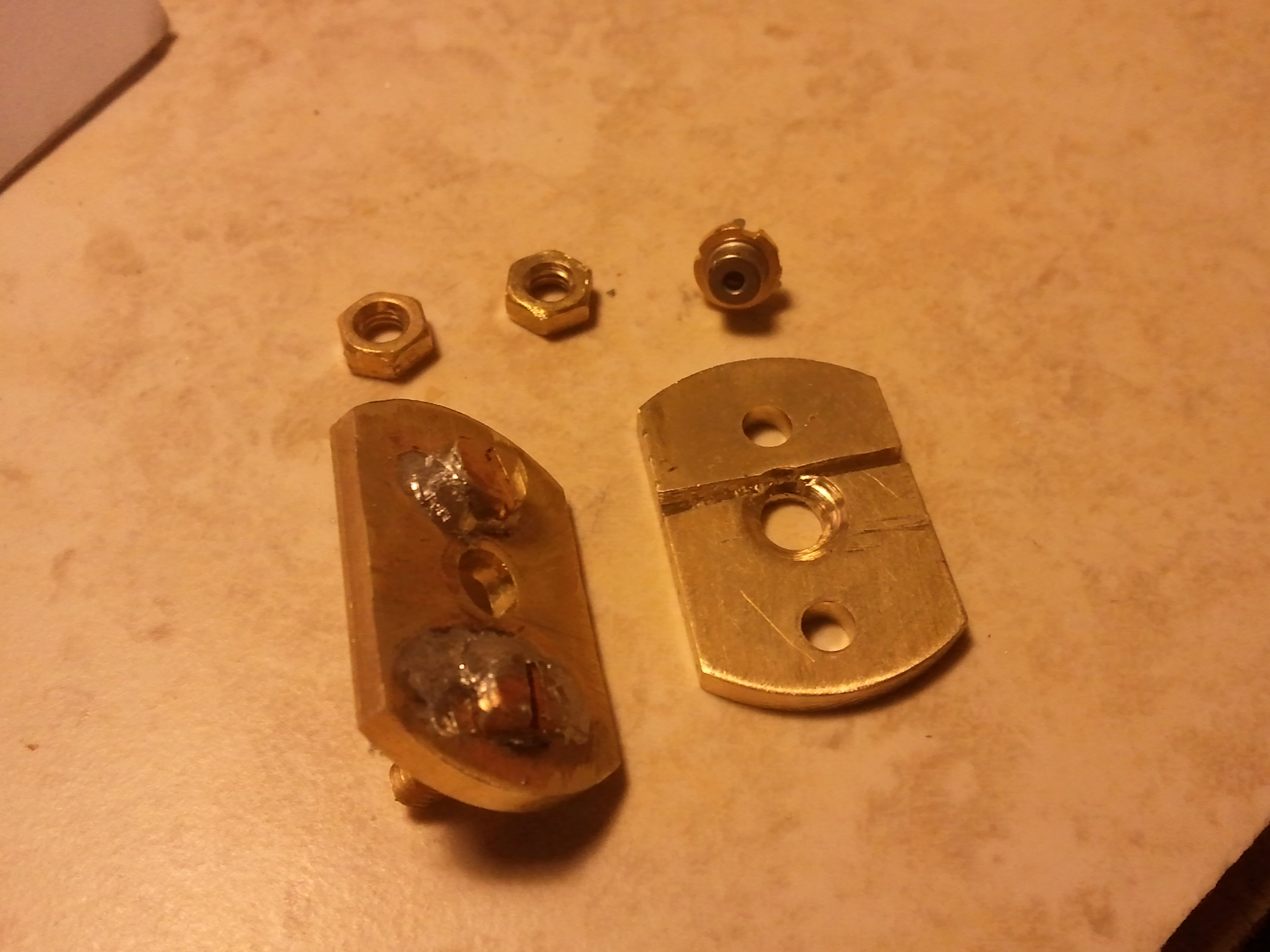

Final question is about diode mounts. I got a nice (and cheap) "C-mount" with a massive aluminium body and a 16-mm lens. I built a small brass thingy to mount a normal 5.6mm diode inside, and tried to focus the beam. I was a bit disappointed, because I could not get a nice spot. I think that this mount is not very efficient because of internal reflections. Do anyone of you have experience with this sort of mount? How are you using them? As of now, the old laser printer thing does a better job! I think this "C-mount" has a lens with a too long focal length, so it does not intercept the full beam.

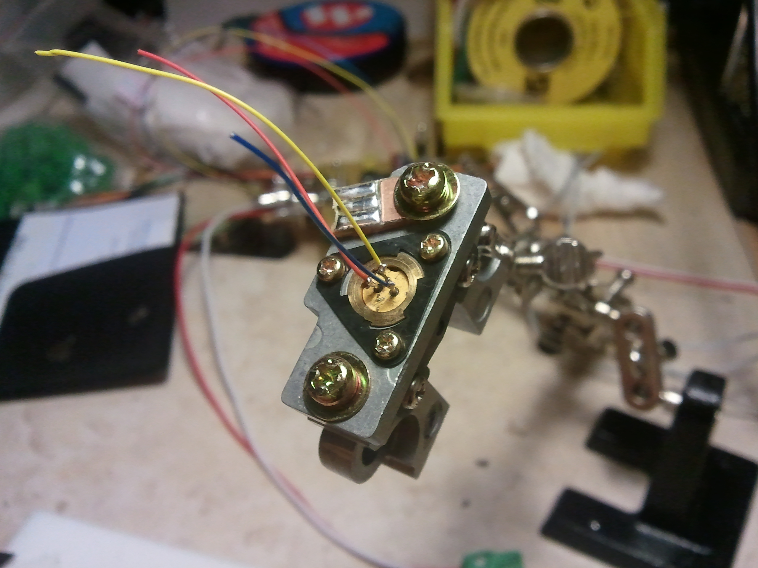

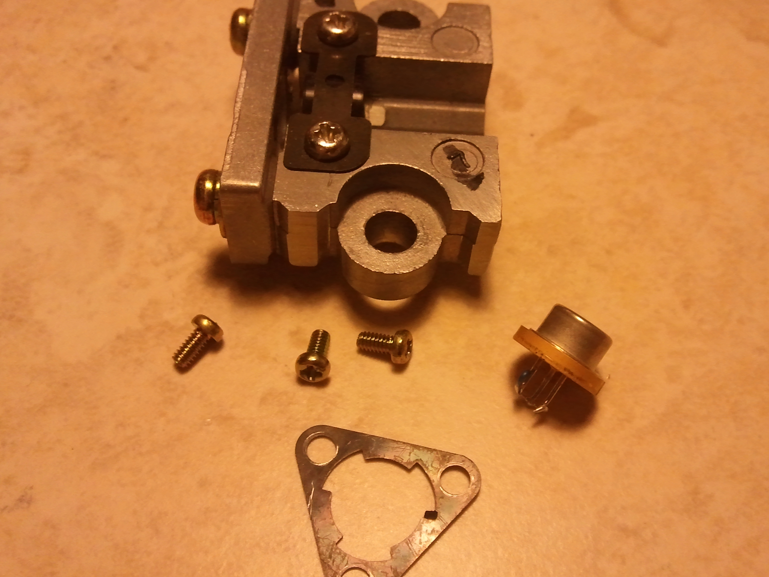

blue diode mount before the diode died
(but I found other ones on ebay)

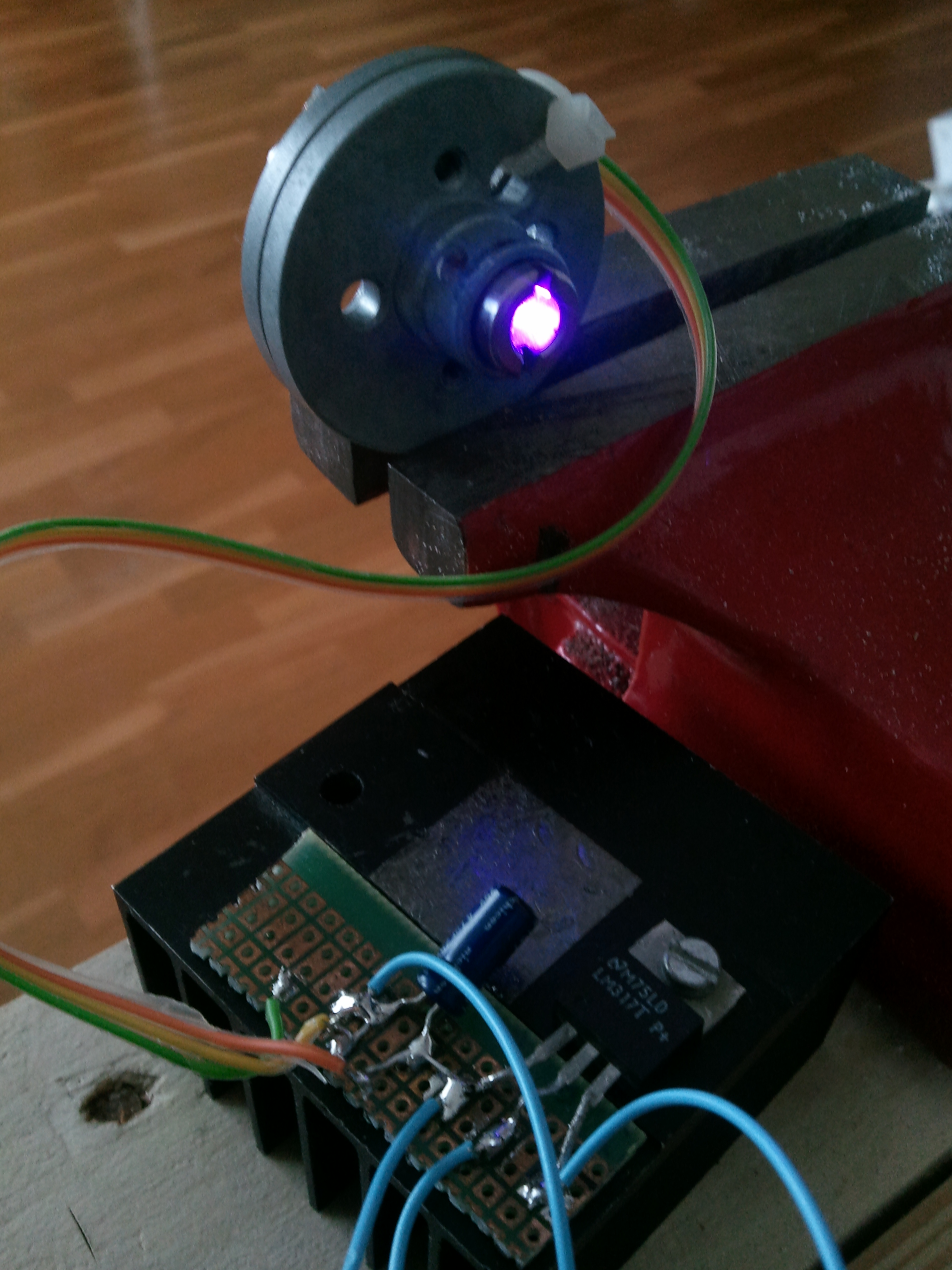

the working driver, and the not-so-nice "C-mount" case
brass mount to fit the 5.6mm diode in the "c-mount" case

same one, with a nice brass 9mm to 5.6mm a friend made for me
