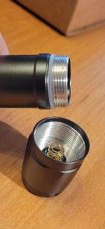

After unscrewing the head, I discover a module coated with thermally conductive silicone paste, secured with an Allen screw.
The head has a glass window (probably covered with a filter). I believe this is to protect the module from moisture.

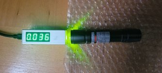

It was time to measure the power. My LPM is a cheap, well-known meter from LPS, but in the limited NANO version powered by USB port (and I love it).
The results I saw after a moment were a whopping 30mW! However, after a ~minute, the result was even higher, and I was more than happy:
