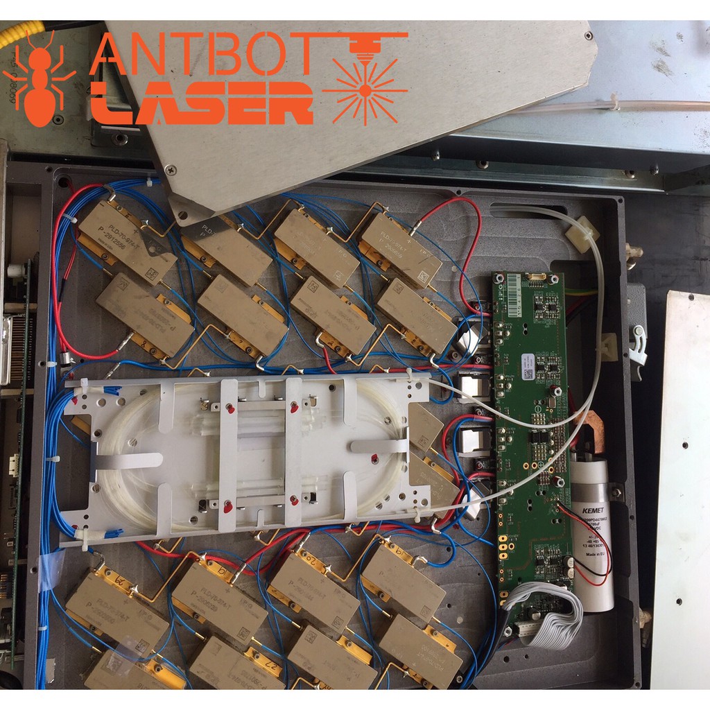

But a great many multi mode pump arrays can be and are combined with much larger fiber and used to pump doped double clad fiber with the inner fiber being the gain medium that a high quality seed laser beam is amplified through.
So when you see a board covered with the little arrays all fiber coupled, those are multi mode arrays which don't have the coherence length we want, like we get from a co2 laser or a double clad active fiber laser.
