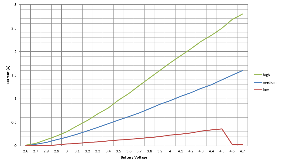

While it does technically have these modes, there is NO regulation. The full battery voltage is passed with a FET into a bank of SMD resistors to limit the current. The modes are created with PWM, so a low battery on "high" will be dimmer than a full battery on "medium." Here is a graph of battery voltage versus current:
There is some strange over-voltage protection thing going on after 4.5V, but only on low mode?? :thinking: Current drops to 30mA. Is that a bug, or is that a feature?
These graph values were measured with a power supply rather than a battery, so it approximates a battery with very low internal resistance (virtually no voltage sag, even with a heavy load). I put a fresh 18650 in there, and current settles around 1.1A. It's about the same for a set of AAAs, oddly enough. I don't see the point of having an XML if you're under-driving it that much.
