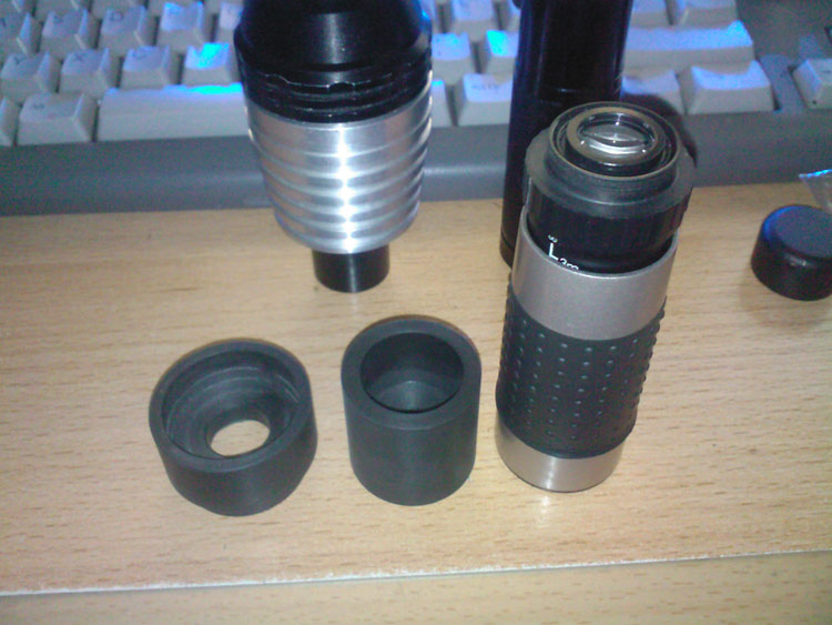

I need one the ceap ones from DL i found are still over my budget for small experiments.
I hear that binoculars work and test it, it work fine.
But i dont want lasing around with my big binoculars.
DX has cheap monoculars, for 13 i get this one:
http://www.dealextreme.com/details.dx/sku.3323
First i think about alloy adapter maybe with setscrews.
But this will scatch my lasers i scary about.
I choose black plastik and lathe tight fitted sittings in the adapters and the laser.
It work its centerd enought and dont fall down.
Sorry for the pictures dslr i have not on hand right now.

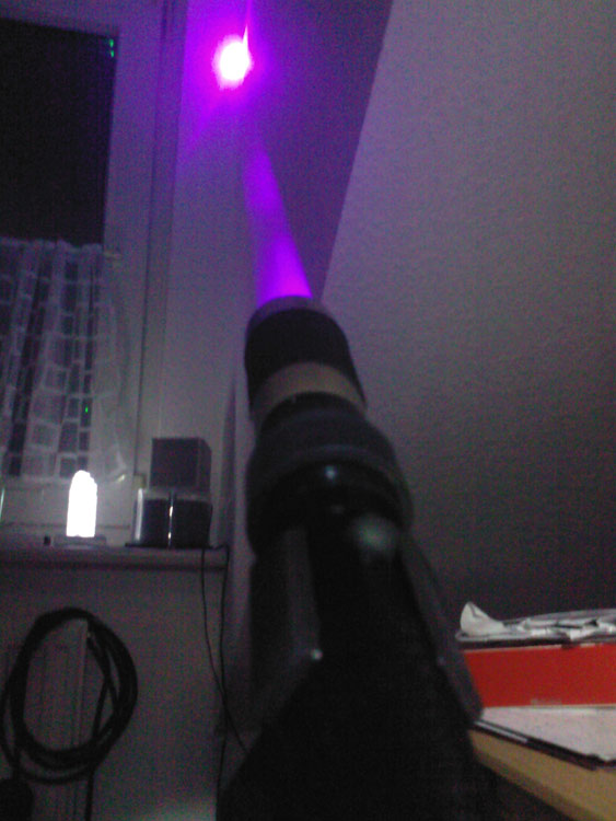

The blu has 130mw output with its aixis lens, for the pic i have to use some smoke.

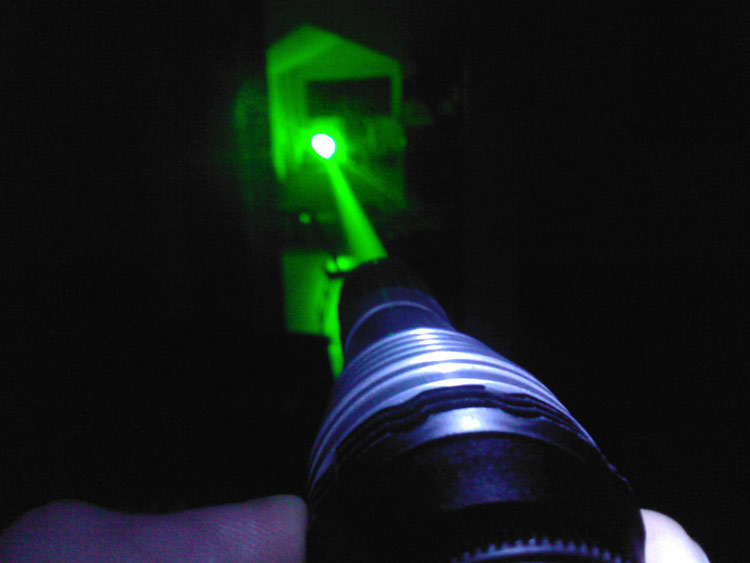

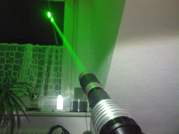

THe green one is a bit offcenter, the adapter fit tight but its mounted on the fokus optik from the laser and this is problem from the wobbling of this fokus thread.

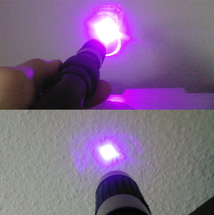

I have a bit scatter around the dot its from internal reflections from the monocular?
For this 13 USd its not great lenses, its a lightwight thing maybe plastik lens.
I think this coast some mw.
I guess the real beam expanders are way better at efficiency and beam quality.
For playing around its nice.
