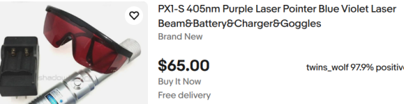

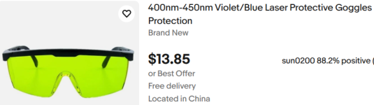

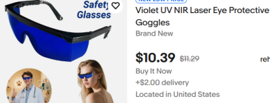

Hi. Saw goggles of several colors sold for protection to violet. Lenses color has no relation to protect from a laser color ?
If someone is working with several wavelenght lasers, can pick any goggles from the pretty colorful pile in the drawer; or the reverse, working behind a certain color goggles will protect from several wavelenghts ? ? :oops: The ones I have and any I see advertised, none is stamped/labeled band-pass, band-cut, 'for protection from such wavelength' 😧
If am working with 'X' wavelegth, are the goggles supposed to block that 'X' to reach my eyes ? Then how do I know what/where the beam is doing ?
Light, please !

It's recommended to use certified laser safety glasses that will attenuate the wavelength you are working with, because wearing the wrong PPE can result in injury, in short you can't choose by color, you need to understand the OD rating and wavelength absorption range.
Choosing the right laser safety glasses is essential for protecting your eyes from harmful laser radiation, and it involves understanding the laser's specifications and ensuring proper fit and comfort.

Thank you, RedCowboy, for a good link on the subject.
The two major things learned here, -in my wording- are :
- The color of the goggle lenses tells nothing related to the wavelenght meant to protect/block/attenuate. Is like a fashion preference. A lens color selected must be tested for blockage of the pertinent beam wavelenght.
The specifications of the product are to be considered and not its color.
- The optical density is the attenuation amount the goggle lens pose to the beam. Too much attenuation and the wearer may not discern where is the beam. Too little attenuation and the beam partially passes the lenses resulting in poor protection.
Hope I got it. :cautious:
