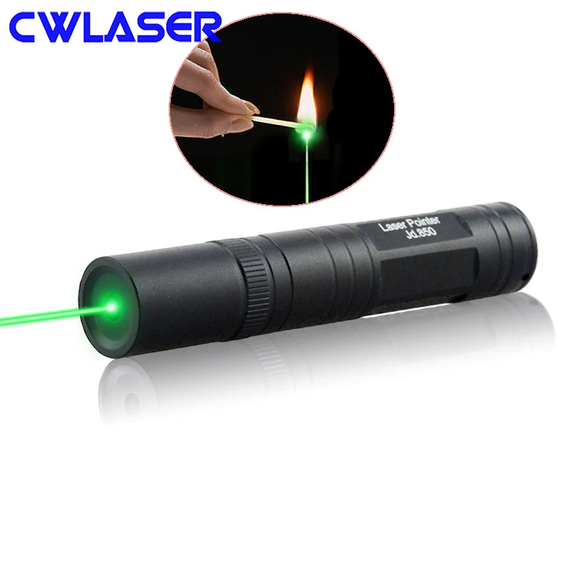

Hello
Today we introduce GH0521DE2G and 532nm laser
520nm 220mw (sharp 520nm 135mw)
LDSE500 (ACS500) 500ma current
10440 2x use
Silver host 532nm
This 532nm is original CWlaser 532nm 200mw module from the china company
Original module
It says 532nm 200mw and can burn matches. But the actual brightness is 532 nm 85mw ~ 120mw
i like DPSS laser. It's very sharp and articulated
i want to make 550ma ~ 600ma next time
This sharp diode looks better than the PLP520B1
First 532nm 85mw (No IR filter)
Second 520nm 220mw
Original module
