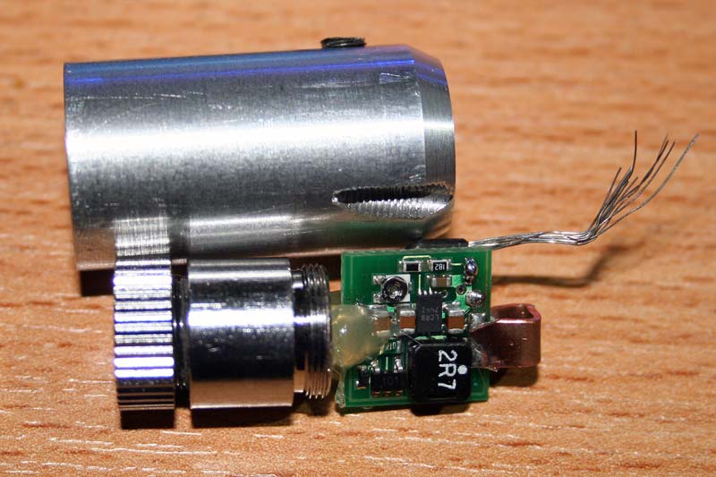

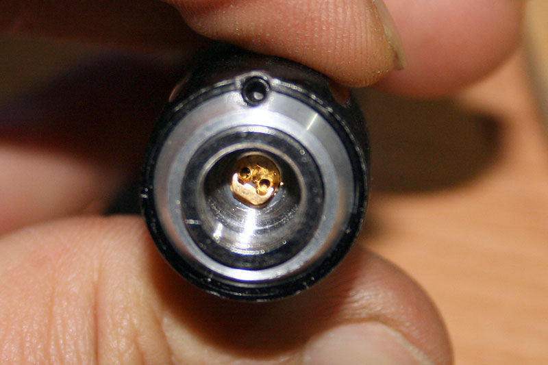

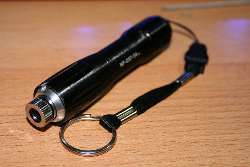

Last Night i finish my pocket Burner Projekt.  :)
I need 2 Dvd Burners for that. The first diode i kill to set up the driver.
dont have test load, normaly i try to find the lowest setting with a high power LED.
Than i hook up the LD and measure direct with the Laser diode.
But the flex pot is filligree and i hit 650ma, i think this kill the first one. :(
Dvd Burners cost 17,- € plus shipping 7 for two pieces, quit cheap from ebay.
http://cgi.ebay.de/ws/eBayISAPI.dll...go=DR&its=S%2BI%2BSS&itu=ISS%2BUCI%2BSI&otn=4

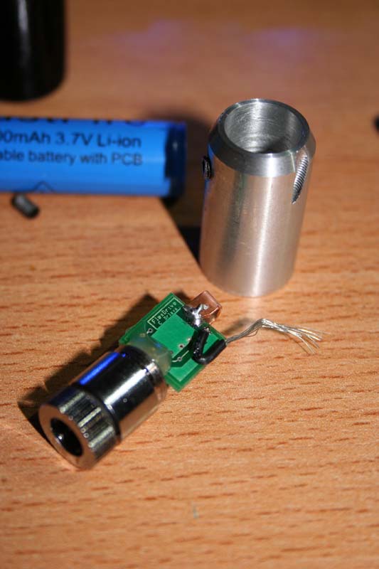

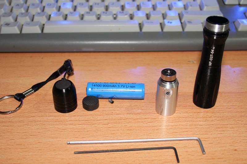

I use:
-cheap Noname 1xaa Host
-selfmade heatsink  8-)
-Aixis modul with Arylic Lens
-Flexdrive @425ma
-Lg 22x Diode
-Trustfire 14500 900mah 3.7V protected

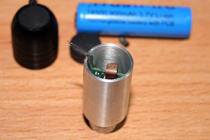

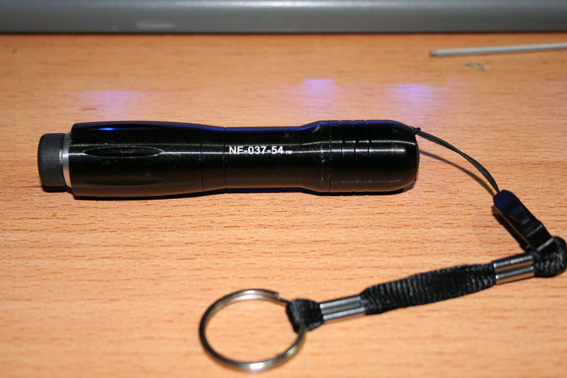

Sweet little pocket monster burner.  :)
piece of copper direct to the anode pin soldert. to batterie +
some hotglue keep the flex in place
beamshots with some cigarettte smoke
20 sec beam killt in black anodised heatsink
