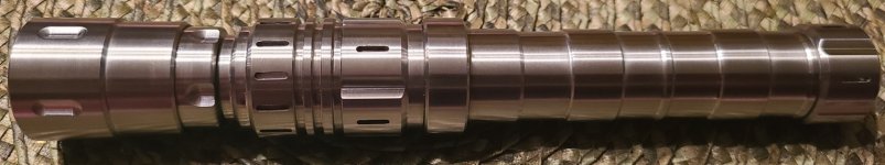

Various Sanwu hosts for size comparison. Ink pen included for reference.

There are 9 different styles of the host to choose from, and they are generally the same other than cosmetics. As far as I can tell from the pics on the Sanwu website, all the Ranger hosts have only one tritium slot on the dimmer switch. The lack of contours for thumb control here seem like a bit of a glaring omission. Even just putting more tritium slots on the dimmer switch would offer enough leverage that the switch could be manipulated with just a thumb, allowing easier one-handed control of the output. You can still find ways to do it with one hand by using two or more fingers, but it takes a little more effort and reduces stability.

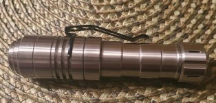

That Big Fat Chónky Laser Butt:
The Ranger tailcap is recessed further inward than the Guardian/Challenger II tailcap.
The scientific nomenclature for every pointer's posterior constituent is "that big fat chonky laser butt" but noobies and peasants often call it a "tailcap". In England it's traditionally known as "'at screwy wobbly clicky bit wot makes it go pchoo-pchoo an'alla'at innit, simple as", while in Michigan it's known simply as "Joe", or sometimes "Billy-Joe".
In addition, the Ranger tailcap is slightly larger in diameter and thus surprisingly (and disappointingly) not interchangeable. The Ranger tailcap also does not have cutaways for easy thumb access like the Guardian/Challenger II tailcap has. This makes the Ranger power button slightly more difficult to press, but also makes the laser safer to carry with live batteries inside of it (although that's still not a good idea unless you want everything you're wearing to be on fire).
There are worse philosophies you could follow, for instance sitting at a desk all day your entire adult life, then dying without ever having truly lived, like a scene out of an inverted and unpleasant Hallmark card.
I prefer having the thumb cutaways for ease of access, but I will concede that not having them is an acceptable safety measure on a powerful pointer like this.
