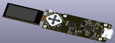

While designing the PCB I ended up with too many LED drivers, I needed one for the backlight of the LCD panel and the IC that was suitable and small had 4 outputs.
Soo I ended up with a new requirement:
I wanted to have backlighted buttons just because :D
Next Step: Starting with the milling.
I started with the "complicated" part. The buttons!
First the Fire button.
Its tiny and needed to have a translucent window.
I again didn't photograph much.
Again 9mm diode for scale.
I did 3 tries, first, easy without window. Second with window but too small. I settled on the third one.
I mocked up some leds to try the translucent window. I only had cold white leds, I will switch to neutral white on the finished PCB.
It's very hard to photograph tiny shiny parts with just a Phone.
Next on: The D-Pad.
I tried a few designs. Some turned out really bad because the Mill I use isn't the most accurate. I still need to figure out how to improve that.
I also managed to squeeze some backligh-able dots into the last design.
Not sure if I really will go that route. I need to get the PCB to try how it looks.
Speaking of the PCB, we have it here:
It's my first time using KiCad and I must say, I quite like it.
The PCB is 18x50mm, features the d-pad, side fire button, all the drivers and the control microcontroller.
It also houses Battery protection and charging.
Its already ordered!
