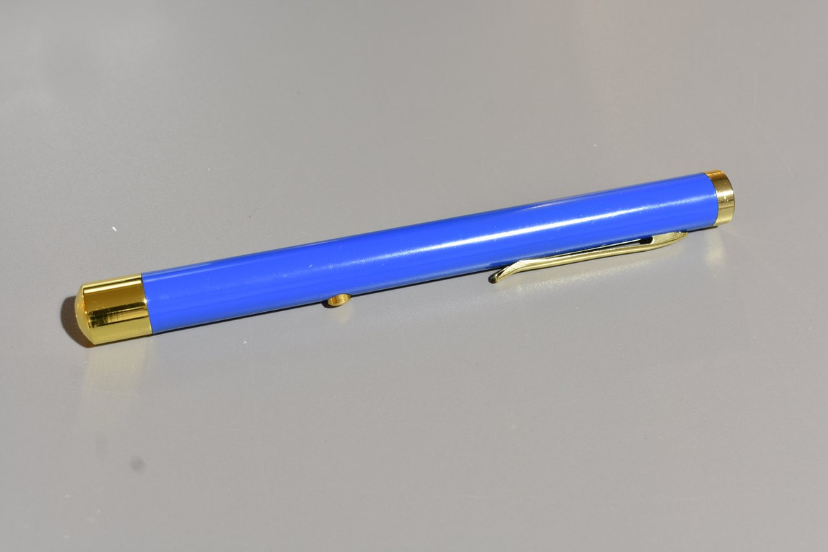

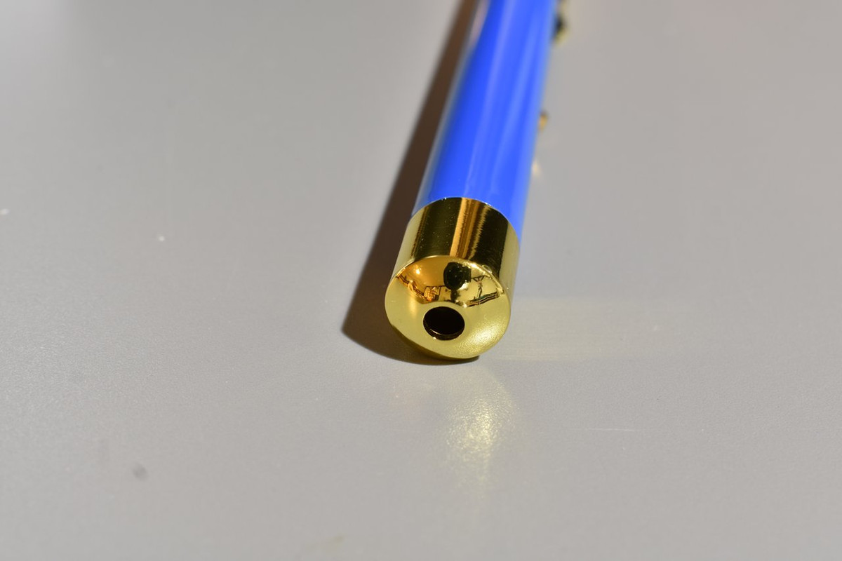

I received my unit, so awesome to have this amazing wavelength in my collection again after all these years! :cool: I'll post some more pictures later, but here are a few that I took today. Mine also does that thing where it starts off lasing green and then suddenly switches over to yellow. Was taking these pictures in my basement and it's pretty cool down here, so this could be why, by mine sometimes takes as long as 20 seconds before it hops to 593.5. Once it goes to yellow though it seems pretty stable.
The unit itself:

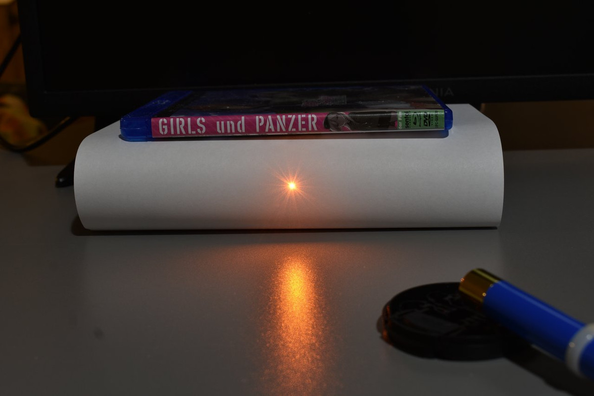

Caught this as it was still lasing green:
Then right after it hopped to yellow:
I don't have an LPM, so don't know the exact output, but this is a comparison with two verified less than 5mW LaserGlow units. 650nm, and 532nm.
