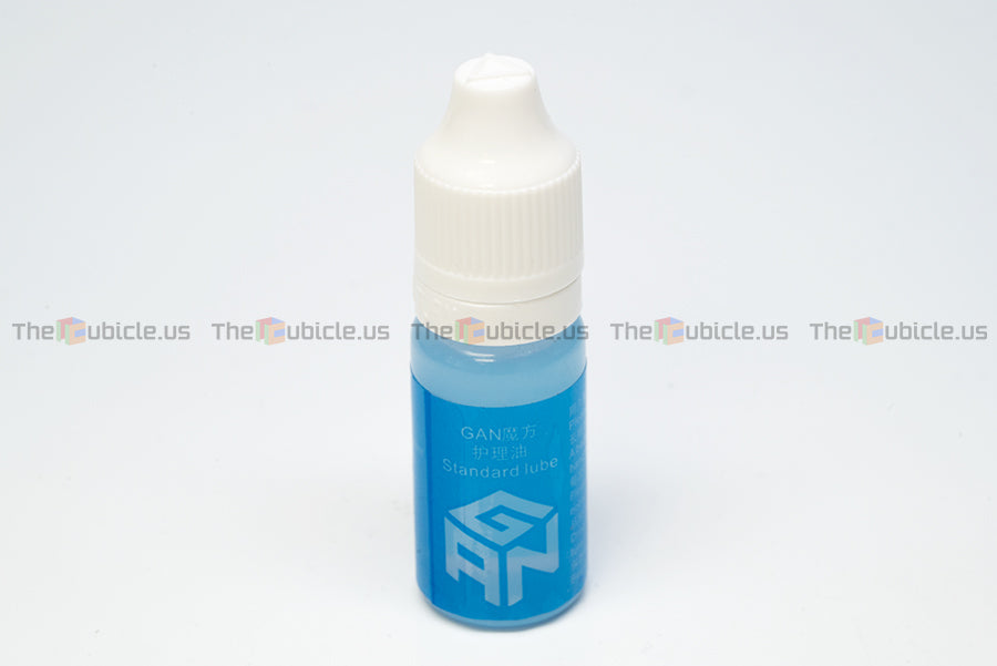

Here's the type of silicone based lubricant that i use for my hosts.
You can also use the silicone lube in RC cars. They are essentially the same stuff. Some are thicker and "stickier" and some are lighter and "runnier". I guess for our use case in laser hosts, the thicker ones would be better as we don't want any lube going where it shouldn't go.
You can also search the term "treadmill silicone oil". Once again its essentially silicone lube.
IMO almost any type of silicone lube can work, as long as it does not contain water.
