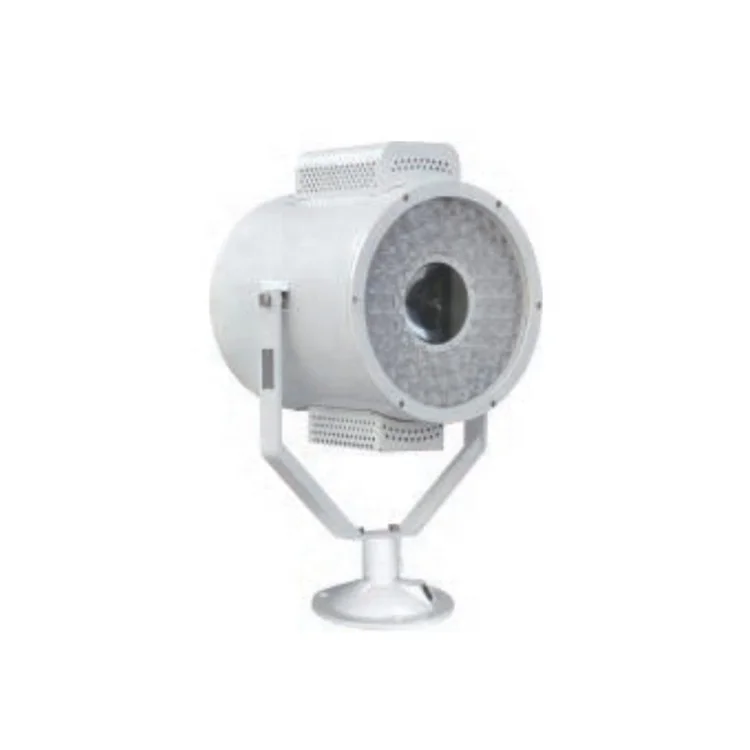

Here's a small increase in power, says 30W however I believe they are counting input power, still they are getting stronger.
Is this what I think it is....says 140w LED and 240W laser......240w LEP in the center ??
