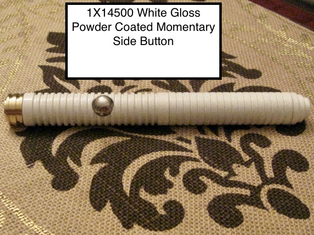

Hi GSS,
There's something about powder coating and copper together just seems right. I think I'm going to put in a 488 in that white powder coated side button 1X14500 host. I think it would go nicely ..
Rich:)

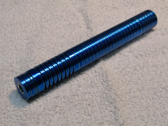

This shiny blue / cyan blue host is also very beautiful and elegant
As it is also that of GSS in small photo and the other at bottom thread ...! so if I understand you do you deal with painting the hosts that LPF members send you? and according to their needs, do you paint their hosts? my compliments then
Dec 15, 2014
6,783
Hi If your referring to powder coating not painting, Yes I can coat hosts only if its aluminum and has no electrical components in it , It must be bare . If I have to refinish the surface that will bring a small additional cost for the job. The Blue host your referring to has a translucent finish over polished aluminum.
